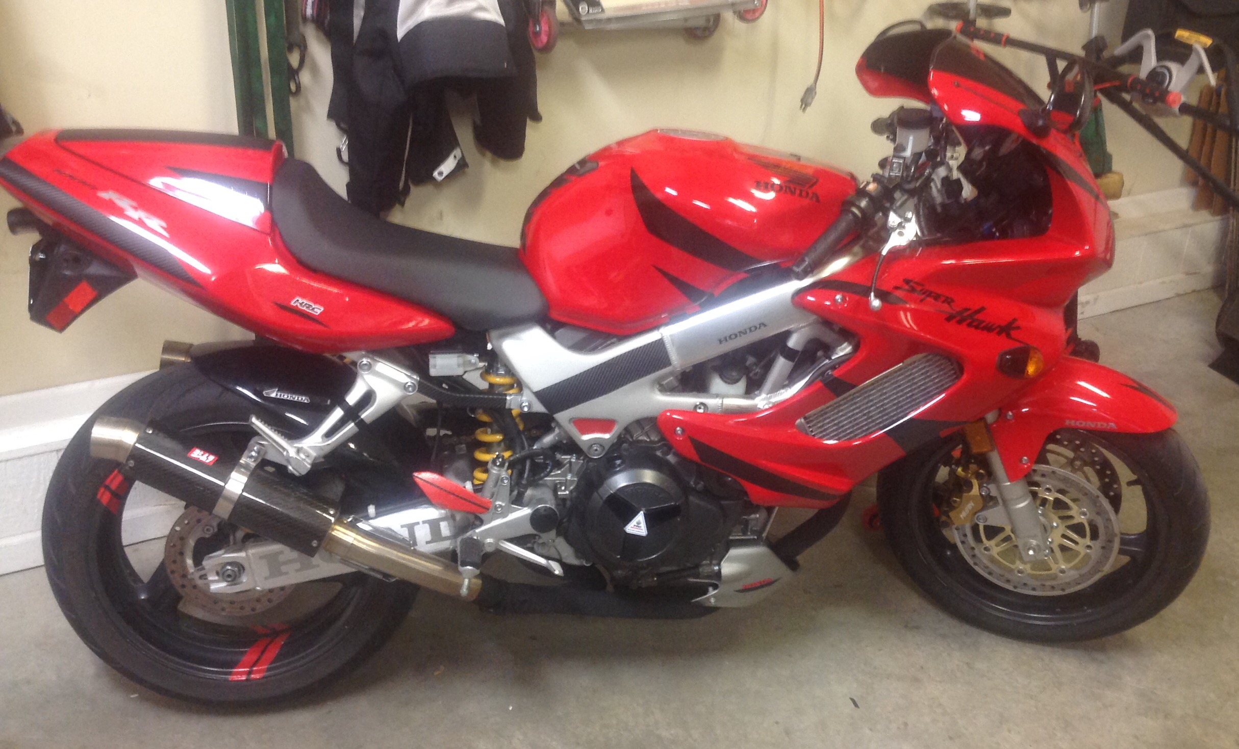

Hey guys I just bought a Super Hawk and it seems to shift hard into second gear is that common for this bike ?
Change the oil
Remove the shifter from the pivot pin and clean, lube reinstall, lube the two ball joints
Make sure the "change Arm" is tight on the shift shaft.
See if you get a better feel.
New shifter from DMr and a Factory Pro shift star and arm with detent is a good option as well.

Originally Posted by RedStormJ
Clunk like dropping a hammer in the case. Mine does that in first or second.
I figured it was because Its a big older bike and neutral is in there.
But dont take me for it Ive had the bike under a month. A lot of my buddies bikes made noise going in first or second.
Neutral to first is a pretty good clunk 1st to 2nd much less so, pretty much a standard shift so long as you shift it with some authority this is not a $40,000 duc with an electronic shift you can't just ease it into gear or toe tap the shifter

Old Aug 29, 2016 | 01:36 AM
To help with gear changes you can load up the gear lever shaft that your gear lever bolts to.
The one that comes out of the engine. Remove the gear lever rod from it , rotate it towards the rear of the engine , hold it in that position and refit the rod. Makes for a shorter more positive action and less chance of a clunk as the shifting is a lot more positive. Did that to my bike years ago and no problems.

Old Aug 29, 2016 | 05:17 AM
https://www.superhawkforum.com/forum...ng-hawk-10161/
Doing the short shifter mod will make the lever movement shorter, but will increase the force needed to shift.
Less angle on arm = shorter travel = more force needed.
If you find that is not a distractor to you then it's a great Mod.
