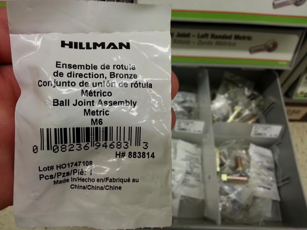

Went to Ace Hardware today to see what it is they in fact have. Here is thier selection:
These are made by Hillman, which I found is carried by Home Depot.

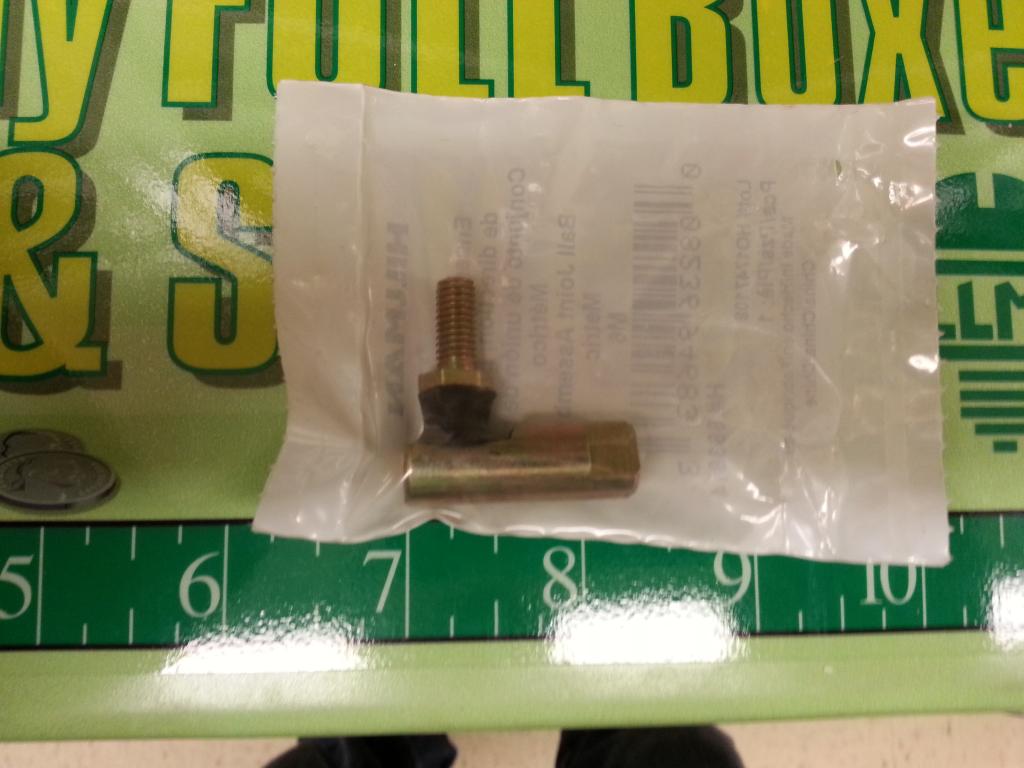

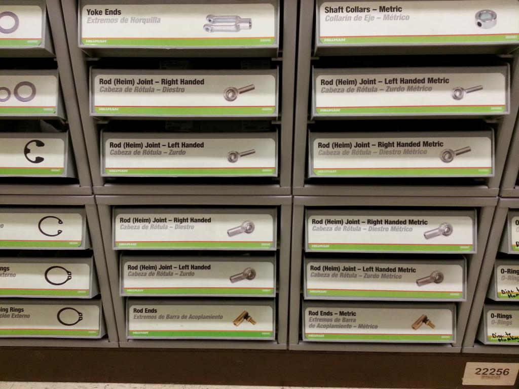

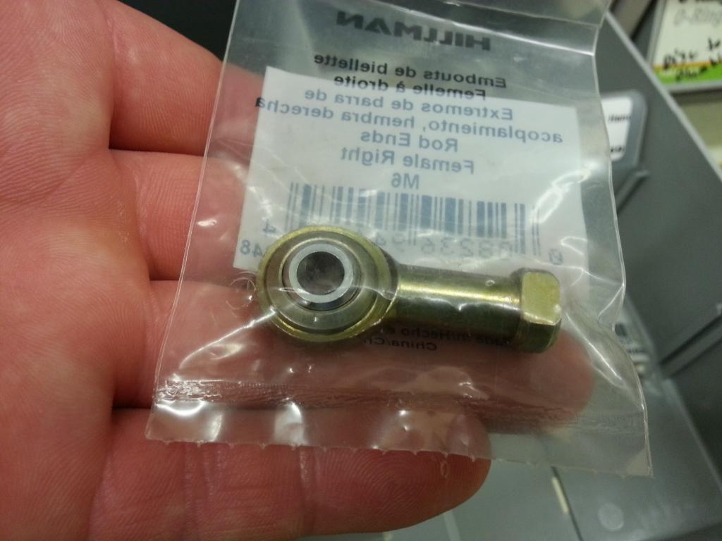

So, I decided to head over to Grainger instead. You pay more, but it's a better product.
I did see that Ace Hardware has nice bronze bushings that will work for the shifter pedal. So, I'm on to figure that out...
