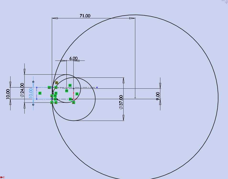

yeah Chris is right it is independent. I may fiddle more with drawings to see how long the tie rods would need to be ideally and I will post up my findings. I may need to do what auto's link showed a rack with the tie rod connectors centered. That way I could make the rods as long as possible because I already have a feeling they still will be too short from ideal.
Old Mar 15, 2010 | 07:49 AM
  #66
Little_Horse's Avatar
2nd mouse gets the cheese
Posts: 1,697
From: Beaverton, OR
ideal tie rod would be 71 in to produce zero change which we already know is not very achievable.
But centering it would help
