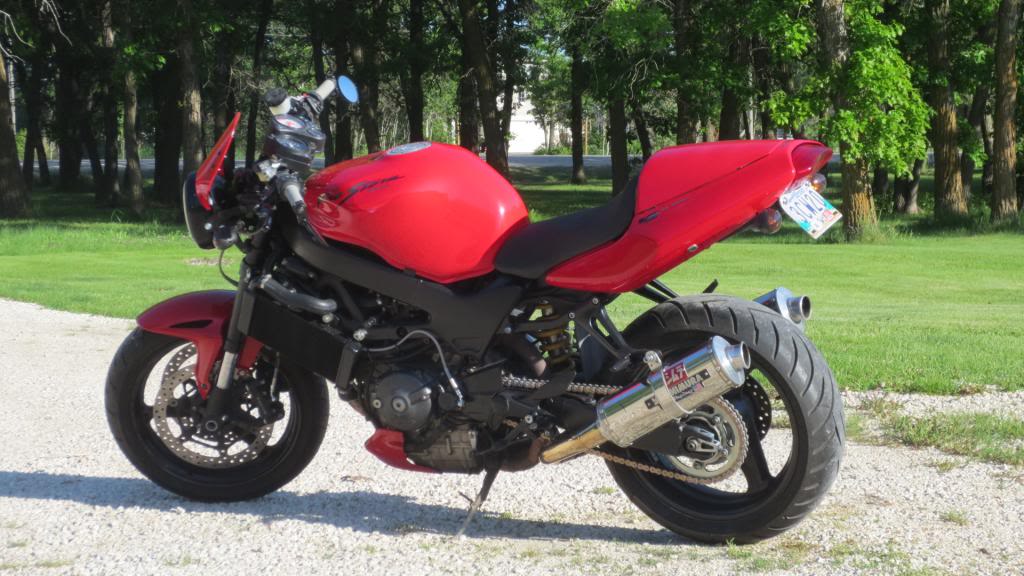

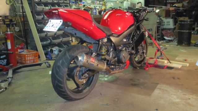

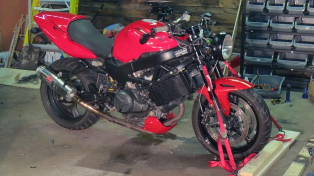

Hey guys,
I bought my Firestorm about 4 years ago, and when I picked it up it was pretty much stock except for some Yoshi slipons ,K&N filter and a aftermarket screen. I always like how the bike pulled like a tractor in every gear, but it definitely had its shortcomings. Having owned nothing but supersport 600's prior to it, I really loved having torque to use and since I don't have a track or decent roads where I live, I thought that it would make a great candidate for a naked bike build.
I never liked how a lot of bikes converted to naked always seemed to looked like they were crashed and cobbled back together, so I wanted to do something that looked classy, but still had some attitude to it. SO with that idea, I started to strip the bike down, sell off the fairings and such and collect parts with the intention of building the bike I imagined.
Unfortunately for my poor VTR, life happened. I had kids, built a house and it got delegated to the back corner of my shop, partially in pieces and covered in boxes of parts that were intended to go on it. I swear I could hear it crying on a quiet night. I really wanted to do something with it, but never could dedicate the time to make it happen.
Luckily for my bike, that time finally came...I spent many late nights in the shop, cursed a lot, and consumed many frosty lager beverages to make my vision come to life. When the smoke cleared, I took a step back and realized that I had just what I wanted...a bike that was comfortable, looking tough but still had a little bit of class. This is just the beginning, as I think I have contracted some OCMD now, so it will only change and improve from here on in.
So, here's a list of all the mods and upgrades that consumed the past 3 weeks of my evenings....

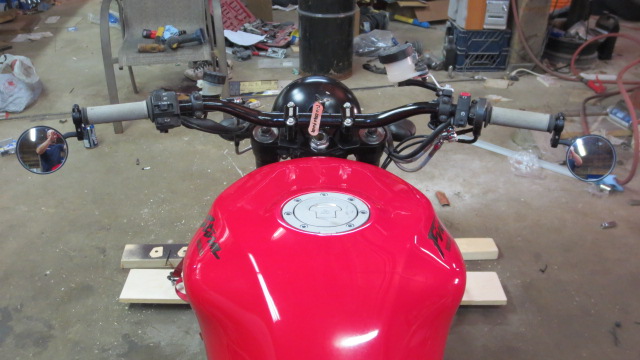

-Hybrid 1998 VTR/2008 CBR1000rr triple trees
-Modded billet 2008 CBR1000rr upper triple tree for dirt bike bars
-2008 CBR1000rr front forks, wheel, brake system, and fender
-Protaper risers and Renthal fatbars and grips
-Russell braided steel brake and clutch lines
-Bar end mirrors
-ASV F3 shorty brake and clutch levers
-Smoked Buell turn signals front and rear
-Custom headlight mount
-blacked out 7inch headlight w/silverstar ultra bulb and custom high power relay system
-Forward wiring harness cleaned up and shortened
-Blacked out and relocated rads w/Engine Ice coolant(don't worry...I only LIGHTLY painted the cores!)
-CBR600rr cluster(not installed yet, still waiting for parts to finish up)
-modified stock CCT housings converted to manual adjustment
-Carbs cleaned and sync'd, #48 pilots installed and TPS reset, new stock filter installed and throttle cables rerouted
-PAIR system delete

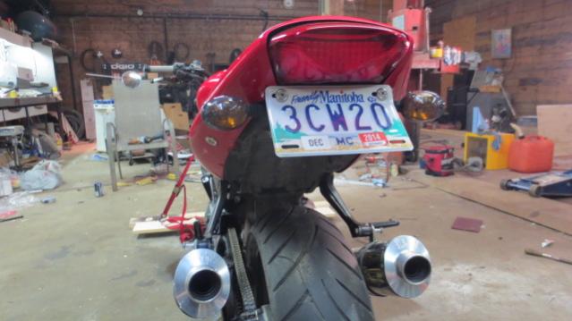

-Relocated license plate mount and seat release with fender delete
-LED taillight mod
-Competition Werks GP foot pegs
-15/43 gearing with DID x-ring chain
-Shortened Yoshi cans by 7 inches
That pretty much does it for mods to the bike, and while it was all apart I painted the frame, subframe, swingarm, rearsets and passenger pegs with satin black boxliner coating, I plan on powdercoating all of it this winter, just wanted to get a feel for the look and wanted something somewhat durable. The last pieces were the stock chin fairing and front fender, which received a "not quite color matching" of the stock red. So, heres some pics, feel free to let me know what you guys think of the finished product, comments and suggestions are appreciated!

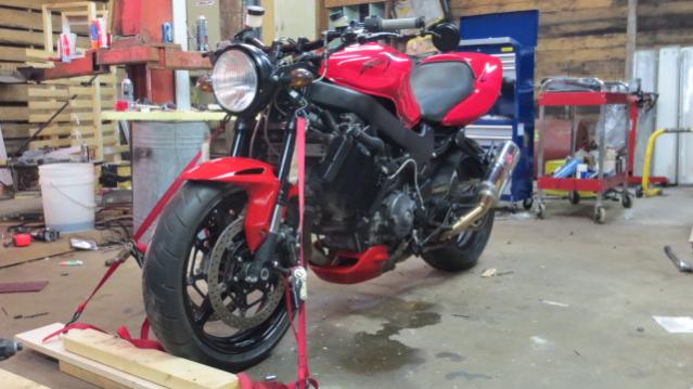

Don't laugh at my "ghetto" hold down, I needed something to work so I could pick up the back to remove the swingarm.....it worked quite well actually. Looking forward to taking out for a ride and see what its like, still need to sort out the rear suspension...time for a F4i shock I think!

Looks great, and I really like your hold-down solution. Looks real handy, and easy to move out of the way when not in use.
Old Jun 7, 2014 | 07:03 AM
scooter72's Avatar
Posts: 189
From: Winnipeg,MB,Canada
scooter72 is on a distinguished road
Thanks! As for the hold down, I just installed a couple of concrete shields into the floor, so when I need it, I just bolt it to the floor and its good to go, I'm going to make one out of metal just to be a little more durable.

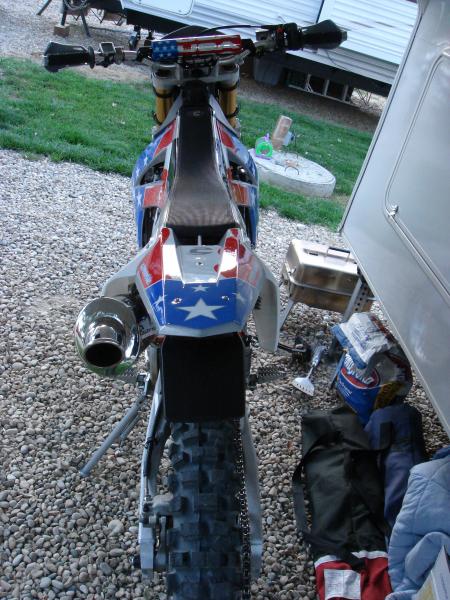

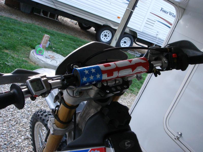

I used a Cateye Enduro2 bicycle computer (speedometer) on a street legal dirtbike I had years ago. It only read up to 62mph, but the new ones read much higher.
It worked great for staying under the legal speed limit. It didn't have a tach, so I just shifted when the power fell away
It was super stealthy, very small and out of the way.
James

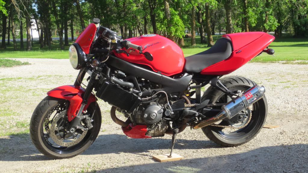

Did a little more work to it, figured a little windscreen would compliment it a lot better, so I cut up an old windshield that was laying around the garage, shaped it, made some brackets, some paint and this is what it came out like....
I think it turned out great, and didn't cost a dime...just what I like. I mounted the stock gauges on the bars for now until I figure out what I'm going to do with that, they seem to work out pretty well there, but are a little bulky.
