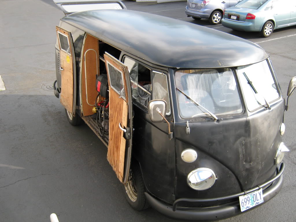

First off, is this a motorcycle only forum? I have not been posting anywhere else about my VW bus project, and was wondering if you guys would take an interest to my project. If no one cares that's alright. My tastes for things may be different then yours. Also my level of crazy has escalated over the last year or so.

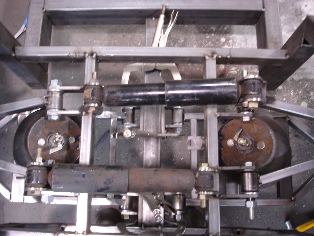

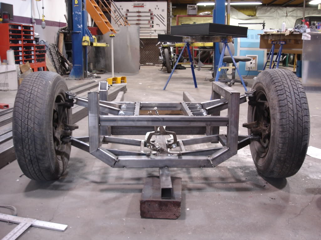

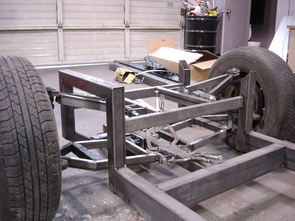

The plan: I want to slam my bus so it will lay frame, hence the title. However I did not want to do it the traditional way and considering the chassis was already bent and the cost of buying specific parts I set out on my quest. I designed a preliminary chassis in Solid Works and went on from there. Collecting Chevy spindles and rims, airbags from ebay, polybushings from airride, I then began... so I have been building a complete rolling chassis, unequal length A arms front and rear. The Chevy spindles also allowed me to have discs on all four as well so she should stop pretty well I figure. I can get into more detail later if you all would like. For know to guage ineterest here are a few pictures of my work so far. Thanks for reading.

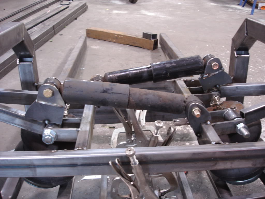

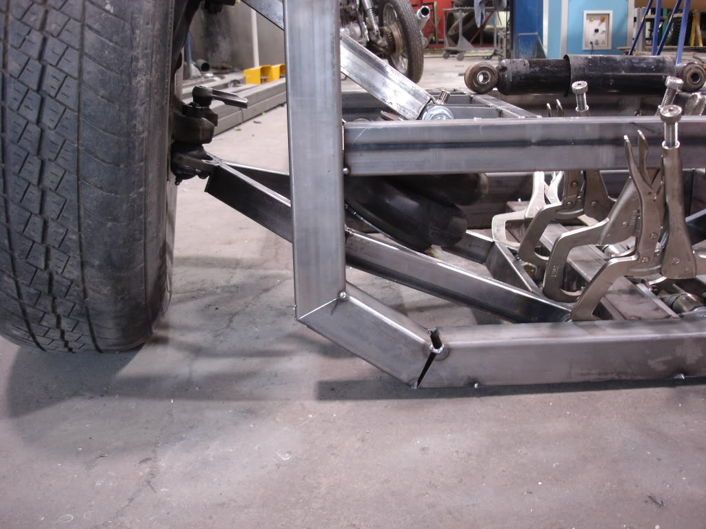

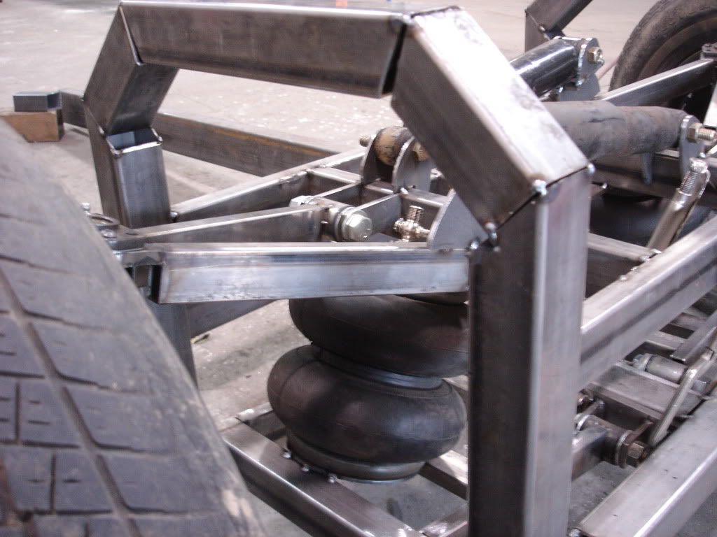

Airsprings and shocks
So I have the air springs mounted and the shocks as well. Here are a few pictures. It is pretty much on to the rear now. I may test it with some load, maybe 1000lbs on the front, and see if she will lift it. Enjoy.
Proof she lays frame
Proof she goes up
Shocks

by the looks of the tires it has an alignment problem....
tim

I am using my own setup, firestone air bags. I will plumb them with mechanical valves and regulators. The frame will double as the air tank, that will be compressed by a audi unit I scavanged from a wrecked car. If you can't tell the build is a total budget type thing. So far I have less the $500 in the project, and considering I have alomost all e parts to complete the chassis I think that is pretty good.
...and Tim the alignment problem is so when I have a knee out I can still maximise the contact patch lol.

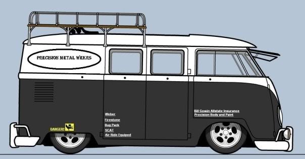

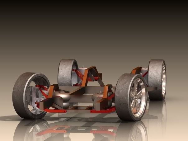

How it started
I started my build by designing the basic layout in solid works. This way I could test it structurally and also make sure there was actually enough room for the air bags among other things. As you can see the idea is there but things have changed. Just thought I would share.
Also here is the look I am going to do, if I don't change my mind by the time I am ready to paint it.

The only problem with trailing arm suspension is that they typically have a toe/camber change issue if they are not run at "ideal" height. How are you going to correct for that?
Old Nov 10, 2009 | 08:45 PM
Little_Horse's Avatar
2nd mouse gets the cheese
Posts: 1,697
From: Beaverton, OR
Well, considering the rear axles are cv jointed the trailing arm itself will not have enough pressure from the axle to pull the camber out of wack. So a really sturdy trailing arm and a jointed axle fixes the camber problem. At least as far I can forsee. Is there something I am missing?
Also for the toe it will be a tied rod to the steering arm that is on the spindle. This will mount directly to the trailing arm. So the whole assembly will rotate as one piece, this should make it impossible for the toe to go out of wack under compression, again unless I am missing something.
Any imput is welcome, preferably before I start building .

as it pivots up, in a typical rear trailing arm design (vw, corvette-gen3, porsche) it will swing through an arc that is not on an axis that is perpendicular to the front/rear of the vehicle. Typically these are at an angle when looked at from above. What this does is give camber change (much needed) during wheel travel, but in many cases (read most) it also induces a toe change (scary corvette handling phenomenon of "wagging" the tail under hard braking). There are ways to correct for these downfalls, and it is adding more linkages and pivots, or create an a-arm suspension. I know that this all seems trivial now, I have general concern for the change in toe/camber on a home designed suspension.
Old Nov 10, 2009 | 09:04 PM
autoteach's Avatar
Posts: 1,611
From: Belgium, WI
sorry that I can't really draw this up, but I will search...
Old Nov 10, 2009 | 09:14 PM
autoteach's Avatar
Posts: 1,611
From: Belgium, WI
http://www.carbibles.com/images/trailingarm.jpg
http://www.autozine.org/technical_sc...spension21.htm
I guess I am referring to semi trailing arm suspension in this case. If you go full trailing arm...no camber change.
