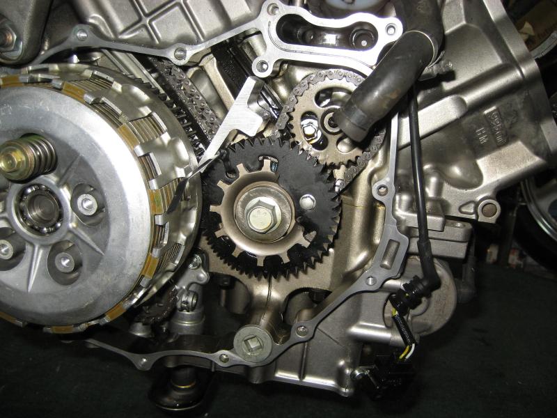

Pulling the cover isn't all that hard. I just unscrewed the pulse pick up from the cover instead of bothering to try and find the harness plug.
I was putting in an advancer when I had the cover off but you can see it hanging on the right of this pic:
The tricky part is putting that #$%@% back on..... Actually it's not that hard if you have a helper and I highly advise you find someone to help hold the gasket and get everything lined up. Try to do it by yourself, well hope you like to cuss....
For sealant, use Hondabond and also only apply it in the sections that are shown in the manual, don't put it on the entire gasket

Make sure you get all the old gasket material off. But be patient, you don't want to gouge or scrape off any magnesium/aluminum.
What usually works to line up the gasket, is to push the bolts through the cover with the gasket attached, then line the cover up with the engine case, start all the bolts before tightening. And don't over torque the bolts.
And yes, an extra pair of hands would be helpful.
