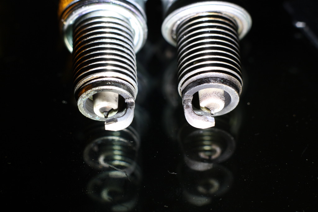

Hey guys I picked up a 98 VTR for a steal. These guys couldn't figure out what was wrong with it. Got it for a grand. I thought my 4 months of experience in a motorcycle shop gave me an edge on them. I was praying for a fuel line issue. But alas all the fuel lines looked to be in the proper position. So I pulled the plugs. The front one looked like it was super rich and the rear looked fine. I replaced the front plug and the plug cap. The air filter was dirty as hell so I slapped a new OEM in there. Bike runs but dies. It has a wicked knock. Won't idle unless rev'ed. I rode it up and down the street a few times to see if I could get more information from the bike. When I pulled the plugs again the rear looked as if it has aluminum flecks on the insulator. I also noticed the rear plug doesn't match the front(I replaced the front with stock the shop only had one plug). Someone put a DPR8EIX-8 plug in the rear cylinder. I know this plug is hotter then the DPR9 that is supposed to be there. I don't have a peak voltage tester. That would be my next step. Not sure how to troubleshoot the ignition system further without the voltage tester. I guess I could run it some more and check the timing but I am worried about running it anymore.
Old May 4, 2016 | 03:09 PM
Ross Cypert's Avatar
Joined: May 2016
Posts: 7
Ross Cypert is on a distinguished road
Rear plug with aluminum deposits is on the right. Bike has 7k miles on it so I am hoping it isn't CCT yet.

That sounds like a compression leak not a knock... Anyone else have an opinion?
