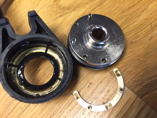

Old May 7, 2015 | 07:39 AM
Hangfly's Avatar
Joined: Mar 2015
Posts: 409
From: Central CA
These switches are nicely engineered.
I knocked this one apart to see what I could see. It was clean inside, but one of the spring ends where it makes contact was worn or had been arcing.
Replacement on the way.
