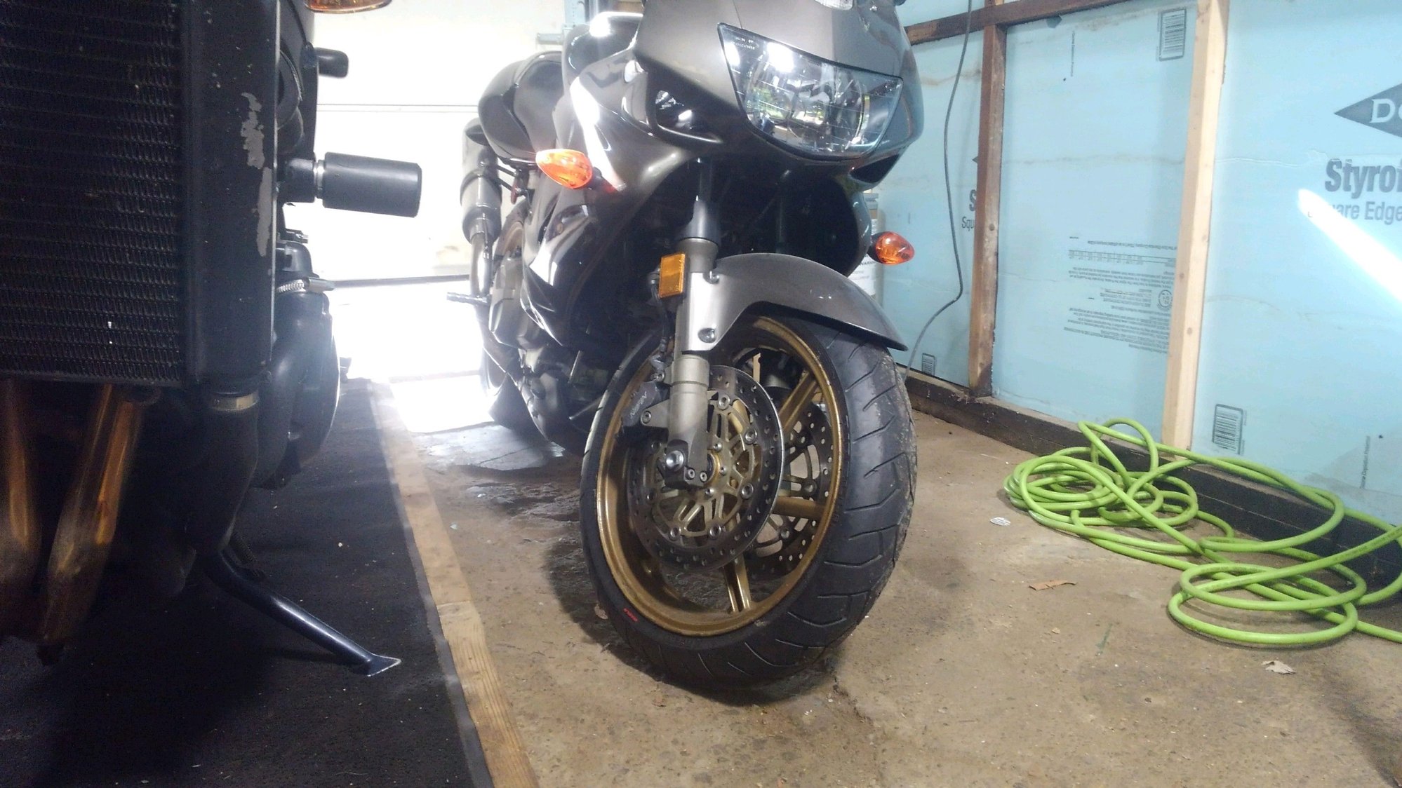

ACE, how 'bout some pics?
Old Jul 28, 2020 | 02:25 PM
ACE VenTRa's Avatar
Joined: Jul 2018
Posts: 565
Here's mine...might be off a 900rr, not sure.
Old May 29, 2021 | 11:42 AM
102dals's Avatar
Posts: 442
From: Little Rock, AR
ACE,
It's a 17" right? If so, which year 900RR is this from? Love the gold BTW.
Thanks
