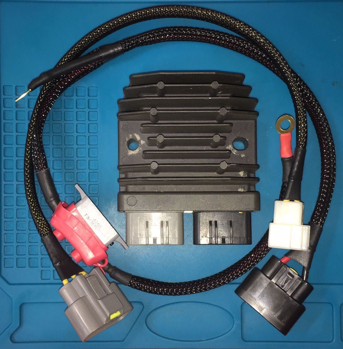

My R/R went out yesterday when driving around town. I have ordered a MOFSET replacement along with the proper wires, however shipping was going to take a while. Is there anything i can do in the meantime to be able to ride? I'd be okay with running an OEM one for a few weeks if I could find one cheap locally. I wasn't sure if anyone knew of anything that I could pick up from a generic parts store.
If not that's fine. I was just hoping to be able to ride while I wait for the upgraded parts to come in.

Any 5 wire RR from a bike 500cc or larger will likely work.
May need to get the harness section with plug to make it compatible.
Out of curiously, who did you get the kit and "proper" wiring from? Was not aware anyone but me made a proper cable to adapt the FH020 RR to a SH.
I bought a FH010 and bought cable from eastern beaver. Eastern beaver sells the cable so you can wire directly into the battery and stator without using stock cables. That's what I was referring to when I said "proper" wiring. I should have specified more.
In all honestly, I can wait for the parts to come. I was just hoping there was a cheap ~20 dollar part at autozone (or similar) that could keep me on the road for a few extra days.

That is a bummer! His latest itineration is literally Plug and Play. Well almost anyways. You do have to mount the R/R and connect the battery leads. LOL

Jim at Eastern Beaver makes good stuff. I have used his produces for a long time, well rather sourced parts from him to make products and do installs.
If it were not for long lead times, higher shipping coupled with he no longer has a lock on the connectors that once he was a sole source for, Id still buy from him..
The FH010 is almost undersized for a VTR as its rated at 25 amps, the VTR is a 23.5 max amp system.
The good news is, if/ when you burn up the FH010, it uses the same connectors as the FH020 shunt MOSFET RR and the SH 847 switching series.
Hopefully you bought a tested good used FH010, not a "New" one ...seeing as there are no New genuine Shindagin FH010 or FH012 being sold, long out of production. FH010 some time before 2010 and FH012 not since just after the Japan Earthquake in 2011.
