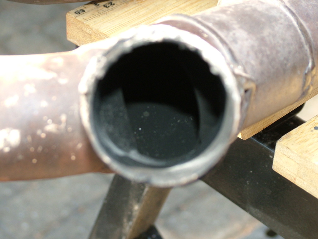

That's normal you don't get the full amount out the right side until you get to higher revs. There's a restrictor plate in the end of the header pipe at the Y junction just before the exhaust gases flow out the right hand side.
Old Apr 25, 2013 | 08:24 AM
+1, at idle (when the exhaust pressure is relatively low) both pipes flow out of the left side. When pressure builds it evens up. Do what Marquez said and check your headers, likely they'll both be the same temp.
