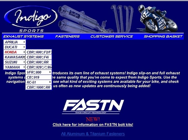

I am an IT server administrator...so please take my word for this, I am not technologically retarded in the least ^.^
**I also noticed their description states passenger pegs retained, whereas mine are gone. Ohh my, I guess I'll call them tomorrow.
Attached Thumbnails Ticking Sound: Share your oppinion-new-bitmap-image-3-.jpg

I'm a web developer! And it's an awfully made site - The VTR menu link is accessible from the RC51 page you linked to but not from the front page or consistently through the site.
I also noticed their decription states passenger pegs retained, whereas mine are gone
The PO probably didn't include the spacer tubes and long bolts that allow the fitment of pillion pegs.

Well... If you dig through the code for the site a little more, the reason that the VTR1000F isn't in the list is pretty obvious...
It's listed as discontinued...
Ie, they removed the link coming from the front page... But, they retained the page on the server, and when you click the menu from that particular page the script generates the menu with that link shown... Since the script doesn't know if a product is active or discontinued, it just renders according to it's parameters...
Moot point as the company is defunct or bougth up and doesn't operate the page anymore... But it should clarify the reason at least...
