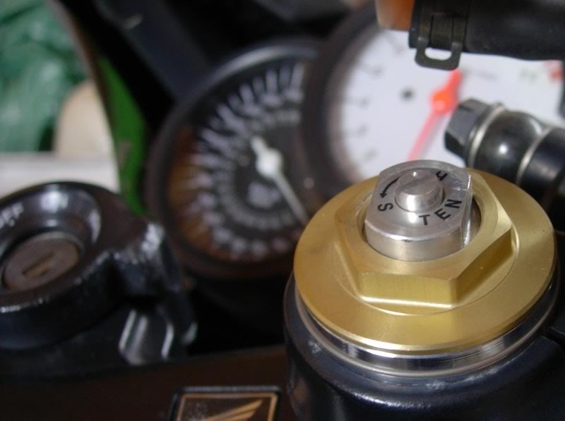

My preloads, yes they are equal.

Um... you are aware that they are set to the absolute maximum preload? ie past the normal setting? That could definetly make them behave odd...
With that setup I would be scared to ride the bike...
If I where in your shoes I'd back it off until the full diameter of the top is visible and see what happens... It can't really make matters worse can it?
I'd say you are overloading your poor springs to the point where they go rigid...

I'm starting to think you have a broken spring or some other damage. If you have the preloads cranked down that far and the bike still sags, as much as you say it does under it's own weight, you have a major problem as this is in no way "normal"

Yes the adjustment was like this when I took the other 2 inch line from full extent pic above, the thing is that I can't remember my bike to be much higher, I assumed it was like this and people were saying that the front suspension sucks, so I always thought that that crappy handling was the nature of the beast, but it got worse lately, no more riding until fixed then.
With a hard spring on one side and the other not holding anything, a weird force is exerced to the front.
Thanks a bunch, I'm an engine guy so suspension settings are out of my field, so all the inputs are greatly appreciated.
I'll tear it apart when I'm done with the garage and post pics.
