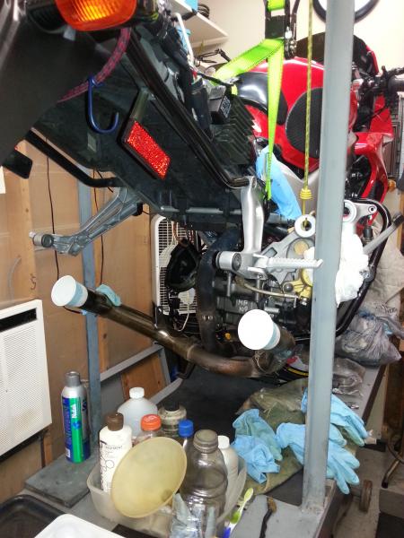

Okay in my on going ordeal I need to replace my left foot rest bracket. How do I remove the swing arm pivot nut? Is this just a brute force thing, or is there more to it?

Just apply force in the normal loosening direction. It's tightened down pretty hard. I always use a cheater bar to help. Yow may need to hold the bolt with a wrench from the right side too.
Old Jun 10, 2014 | 02:25 PM
Posts: 2,223
1/2-inch drive sockets are best as it's torqued to 69 F#, so stiction makes it tough to budge. Be thankfull its not the right side footpeg bracket you need to replace because then the pivot bolt has to then come out too (remove the rear wheel and tape the threads on the axle bolt to use to "drive" out the SA pivot bolt)!
I know...if it were the right side it would just stay bent, but since I thought the left side would be easy, here we are.

Air compressor, impact gun, sockets. Off in 5 seconds.

Just used my torque wrench as an untorque wrench lol.
Problem solved
