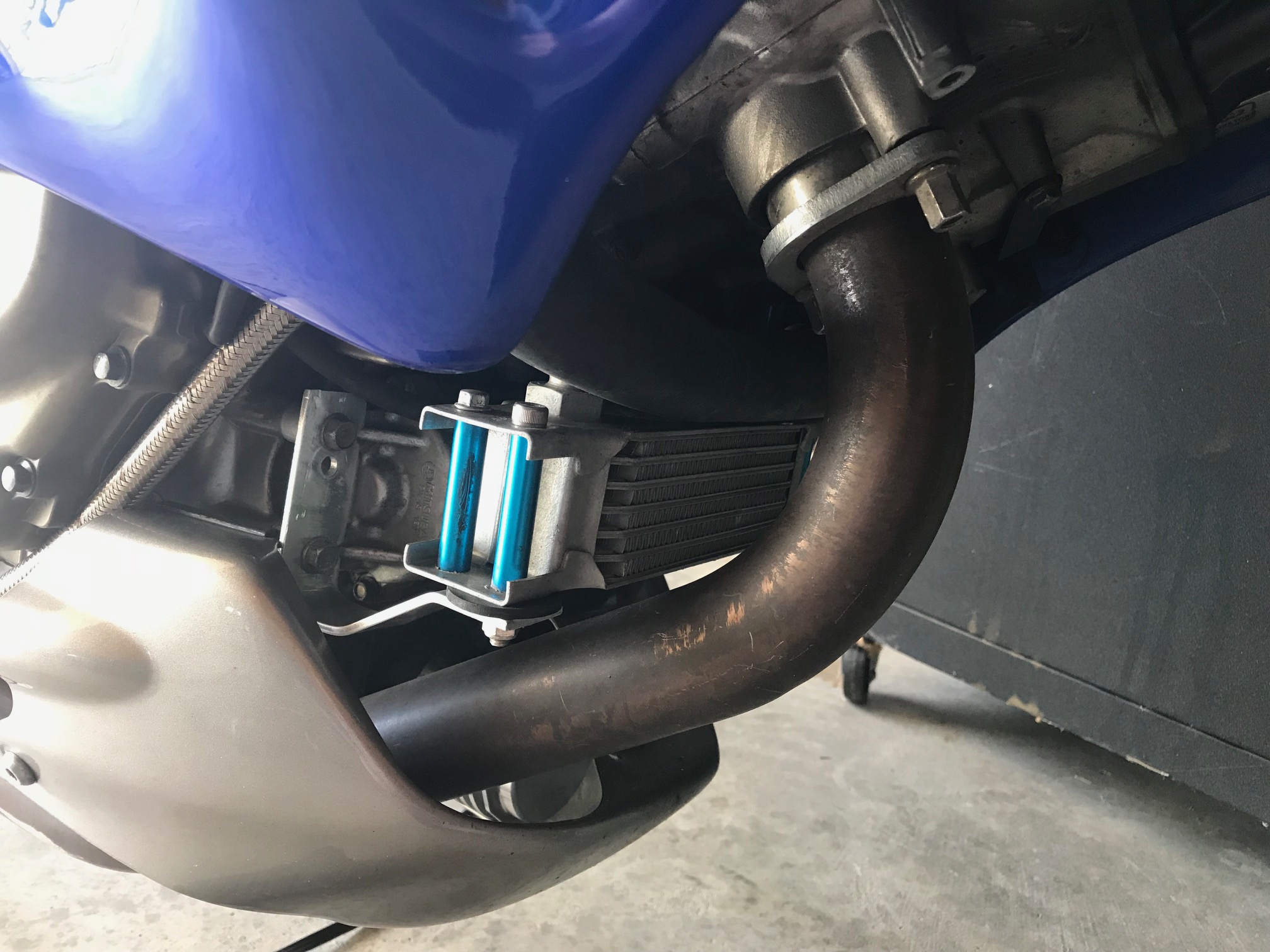

I mounted a larger oil cooler behind the header, at the base of the engine. Not sure what I lost through positioning there, but it definitely runs cooler than with the stock cooler in the stock location.
Alan
Not a criticism of what you did, the results speak to the mod working. It's just that it doesn't look right. Having something that is cooling the motor next to something that's really hot.
Old Apr 5, 2018 | 06:15 PM
Yeah where I live that would be an oil boiler

Being and ex-racer/ex-stunt rider, engine temp became more important than rear wheel traction. I agree xeris and joe. I'm thinking of possibly mounting a vertical cooler on one side of the header as forward as possible with a side shield directing the excess air flow towards the side radiator, using a deep vertical radiator (dirt bike type) on the other side of the header with a side shield as well. This way I utilize the same amount of square footage of air drag hitting the bike while taking advantage of the air drag. Florida traffic can really make it a hot ride.

The ducati monster way. Great in a gravel less world. At least it has its own clean air and doesn't block the rads which are starving already. The bigger rads are all that cooled things better for me. 8 row cooler just blocked them.

While some might say the oil cooler behind the header is an issue, as you can see it is the "normal" spot to mount the oil cooler.
So either the Moriwaki boys made a major mistake (I have plenty of other pics but all the Mori built bikes ran the cooler in that location) or there is no real issue running the cooler in that location.

Wow Hawk, great image. Off topic, but I'm assuming that the exhaust is Moriwaki. It has the same duodenum as the Akrapovic headers

The purpose for that bike is about 100% different from the riders on this forum.
So yes, if you hold your bike at redline all day and have nothing but open racetrack in front of you, have at it.
For the guys on the street who have drastically different parameters, like, say, stoplights, speedlimits, traffic or law enforcement, (or for some reason cant open it up in top gear down your driveway or street) I would say that location is still an oil boiler.

Folks, opinions--mine included--are like, well...you know. Rather than take this thread any further out into left field, I'm going to start another and elicit some objective help with the wisdom of my oil-cooler placement. Please chime in.
About all I can say is that if it is such an issue running the oil cooler in that location, because the heat will cause all kinds of issues, then what about the lower radiator hose?
It runs in basically the same location as the relocated oil cooler. The rubber hose doesn't melt. The cooling system seems to have no issues with a hose by the header. In fact it causes no issues what so ever.
So why would you have an issue with a metal oil cooler? If there was enough heat to "boil" the oil wouldn't the coolant in the rubber hose turn to steam long before that happened?
Unless there is some real proof that running the oil cooler down low actually causes an issue I will continue to mount them in the lower location and have never run into any problems with the mounting location.
Plus it gives the added bonus of removing the hot air coming off the cooler from entering the airbox.
Carry On.
