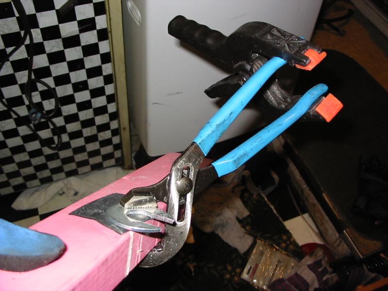

Rear shim makes huge difference. Make a couple so you can try different thicknesses.
You can use my patented cadcam design and laser cut system.
Thats some innovation going on right there.
But really you were doing that in your kitchen? Was the wife out?
I especially like the clamp on the channel locks to hold everything down!

Its NYC. Its either kitchen or busy street. Easier to plug in jigsaw in kitchen.
I was a full time racer when I met my wife so she's cool with all of it. (true love).

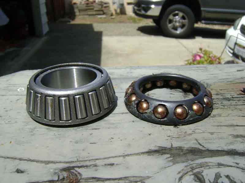

szwillys's Avatar
Posts: 6
szwillys is on a distinguished road
I just finished the same mod today. I will test the Hawk tomorrow. I was shocked by the difference between the All ***** bearing and the stock bearing. Here is a pic
