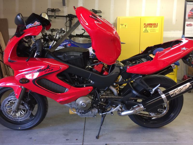

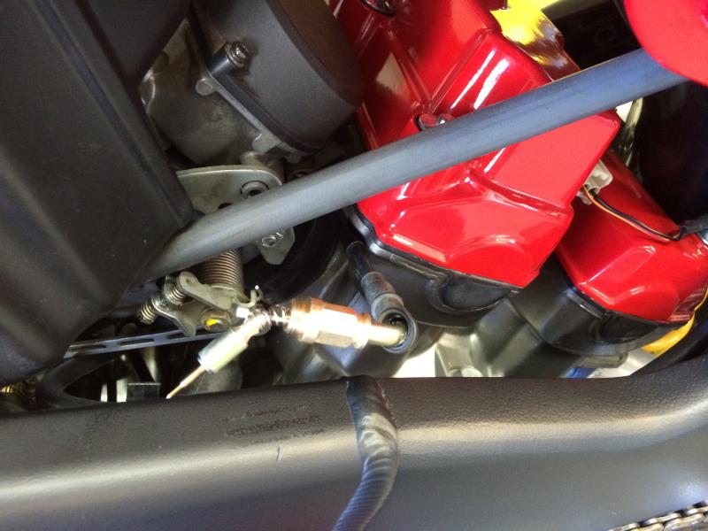

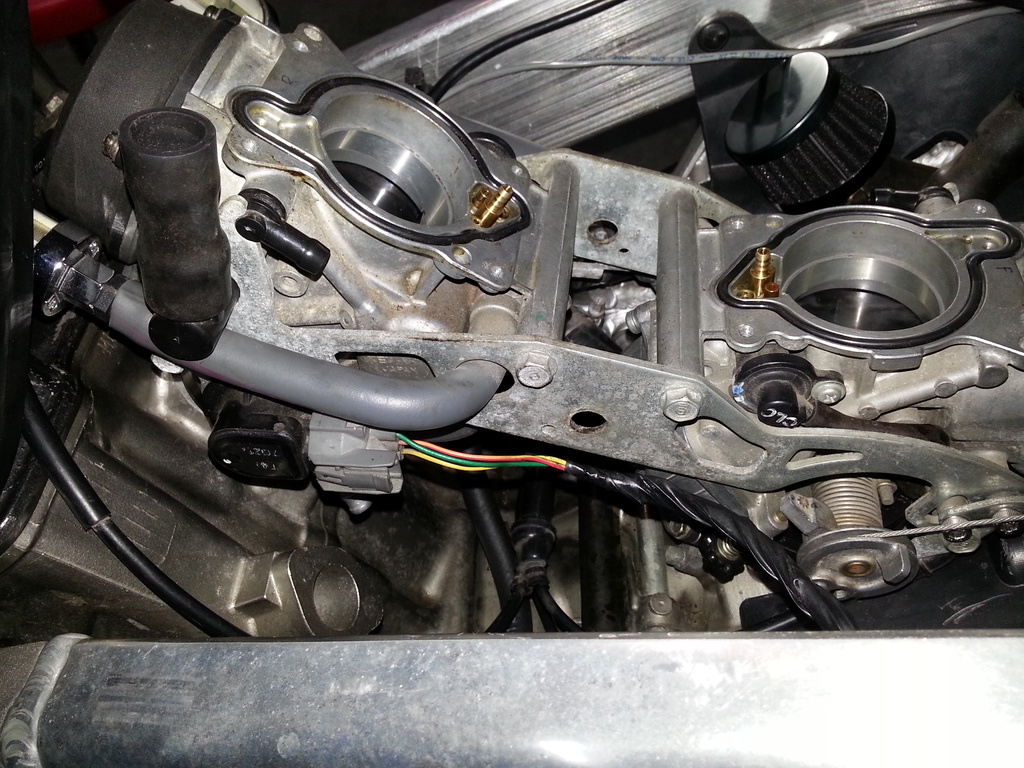

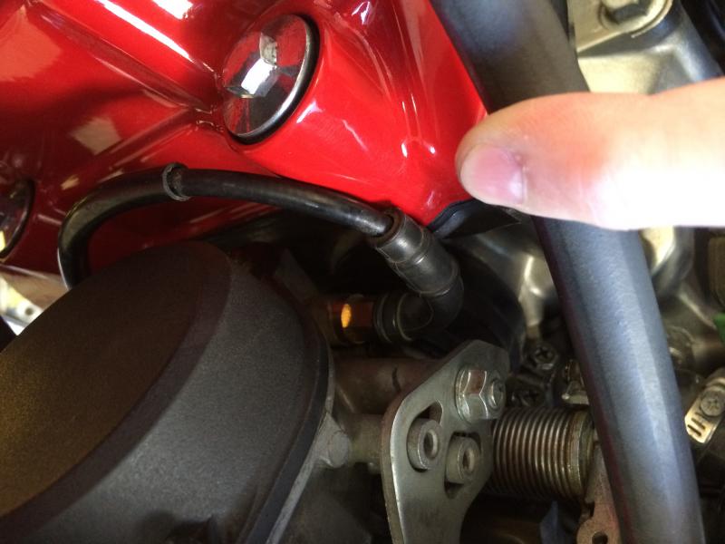

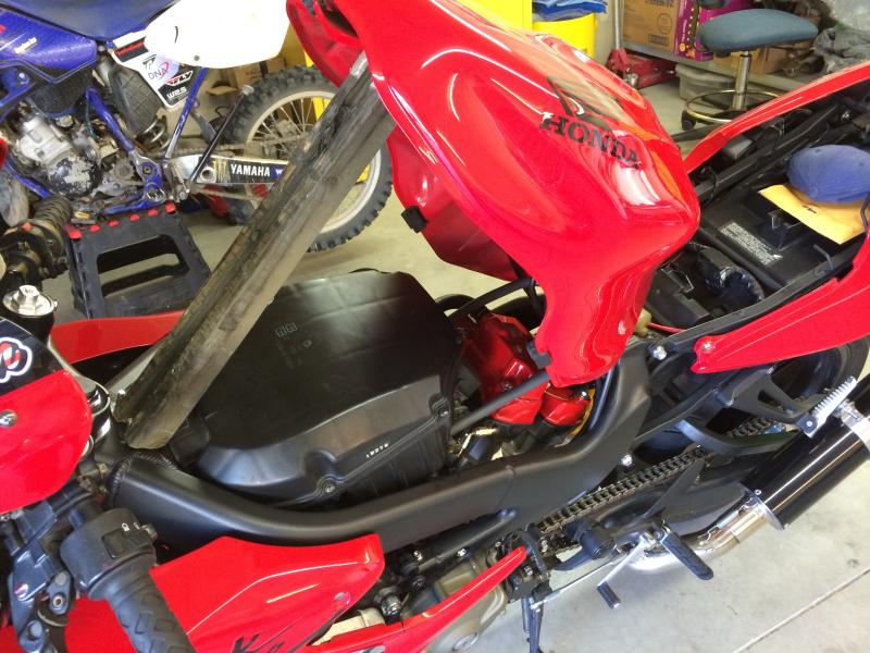

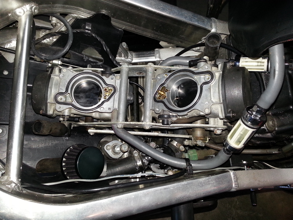

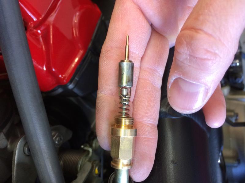

I removed the seat today, popped the two cotter pins on the front of the gas tank, and propped it up to work on the choke cables...
I pulled the rear one off and checked it, seemed okay. I followed the cable routing to the rear carb and noticed i had routed the cable in a pretty tight loop around the FRONT of the rear cylinder, then routed up to the rear carb on the left side of the bike... I changed that so now the cable is routed around the right side of the rear cylinder, coming to the rear carb from over the top of the carb. See pics to make sense of what i am saying...
The cable is still hard to pull, but it could be how tight i have the knurled nut by the mounting bracket... I will also check the front cable later this week, remove it and make sure it looks good.
I will also order an air filter tonight on Amazon Prime ($21 Emgo), plus there is a full tank of gas mixed with seafoam... I'm attempting to try all the suggestions here
James

Old Apr 15, 2015 | 08:52 PM
  #52
thedeatons's Avatar
Joined: Feb 2013
Posts: 1,510
Pic 2
Attached Thumbnails Starting with cold engine - Enrichener questions-image.jpg

Pic 3

Pic 4

Pic 5

Seems to work a little better after changing the choke cable routing. I have a new air filter on the way, but it's not installed at this point.
I wish i had caught it in time before it shut off, and pushed the **** in a bit, it may have stayed running.
This is actually the best it's done in a long time It was about 67 degrees out when this video was made.
http://youtu.be/wzM2sCjrejU
Feedback? Thoughts?
James

Old Apr 16, 2015 | 07:41 PM
  #57
Here is how my choke cables are routed. Just for reference.
EDIT: Seems we posted at the same time. I will check out your video.

Old Apr 16, 2015 | 08:16 PM
  #58
thedeatons's Avatar
Joined: Feb 2013
Posts: 1,510
Try it now.
My cable routing now looks the same. It didn't before...
James

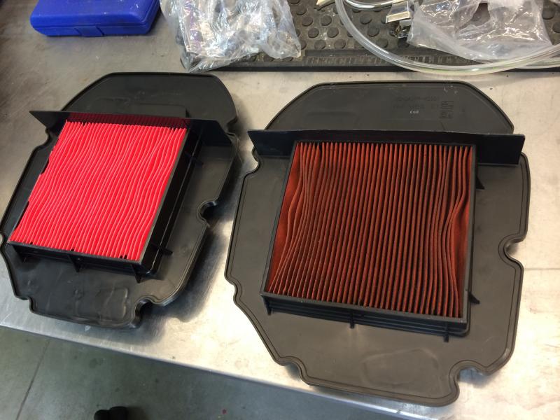

Changed the air filter yesterday.
Will try and start it cold on Sunday and give a full report.
James
