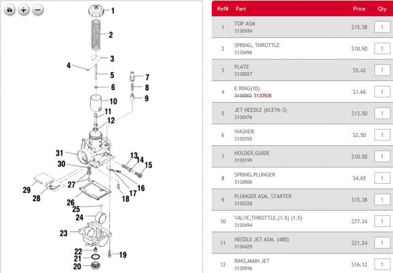

Old Nov 22, 2014 | 08:50 AM
James, the main issue with the enricher is that the weak 90 degree bends are made of plastic. I and others have replaced the with a Polaris metal part. It is hugely worth it since once its broken (it will) it will always tend to richen your carbs. Order the Polaris parts before you disassemble.
I would daresay that this is what is happening to all these guys who are having trouble since even a crack in the plastic comprimises the integrity of the part.
Just do the change I promise its worth it.
Old Nov 22, 2014 | 02:50 PM
hondavtr1000sp2's Avatar
Posts: 348
From: Melbourne Australia
Smokinjoe, would you be able to add a part # & link where to get the Polaris parts. Sounds like these parts will help a few people.
Please & Thank you !
Old Nov 22, 2014 | 03:17 PM
Wicky's Avatar
Posts: 1,707
From: Essex, UK
Search the forum for> polaris choke < Plus in the UK we have a chap making brass or titanium alternatives.
Old Nov 22, 2014 | 03:25 PM
Yeah, on this your search is as good (or better) than mine. I am a poor searcher but there is a lot written on it.
Old Nov 22, 2014 | 06:34 PM
Posts: 348
Polaris OEM Parts,
Polaris ATV OEM Parts,
2000 Polaris XPLORER 400 (A00CG38CA) Parts
Part # HOLDER,GUIDE
3130199
Price, around $10.
Part needs modification for those that don't know !
