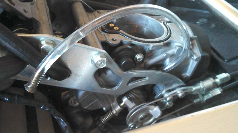

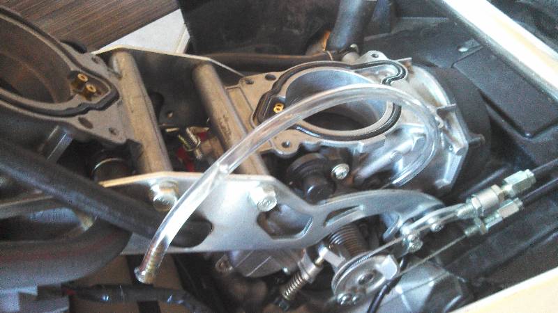

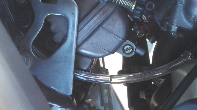

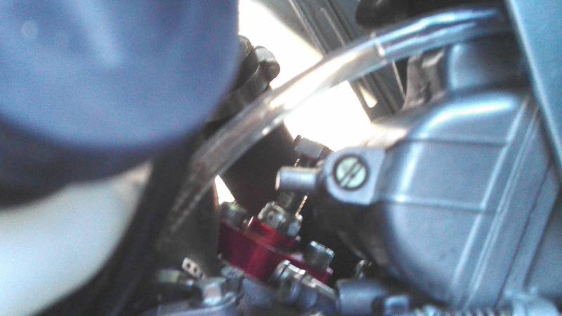

Fuel in a vac line??
This morning after I put the bike back together, she fired right up… I let her idle to warm up, then to take her down the street. Again at 4K she started to sputter and bog down (almost sounded like a 2 stroke) belching out blue smoke from her pipes. I noticed a nasty fuel smell.. I limped her back down to my pad and tore off the tank again. I noticed something I haven’t seen before.. fuel in a vacuum line.. I do not know what this line is for. 3 years ago I preformed a PAIR removal.. but this is new to me… I have attached a few pix ..
Attached Thumbnails The SAGA continues.....-optimized-fuel-7.jpg   The SAGA continues.....-optimized-fuel-1.jpg   The SAGA continues.....-optimized-fuel-2.jpg   The SAGA continues.....-optimized-fuel-3.jpg

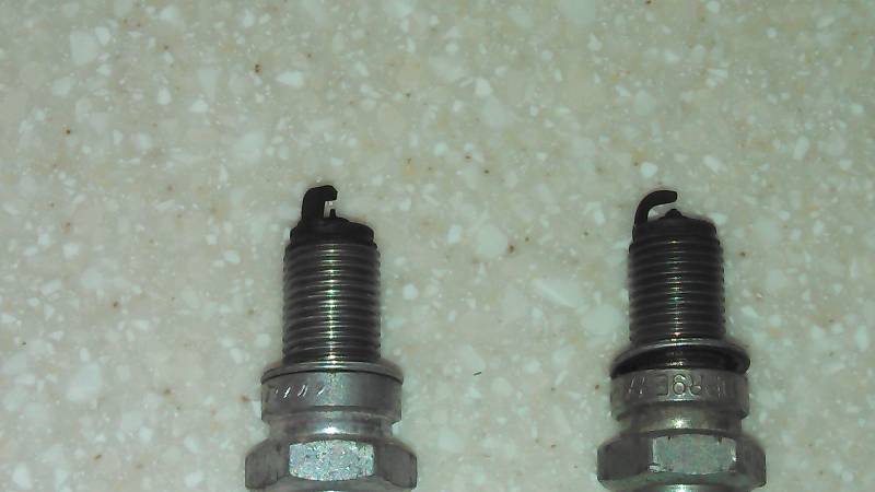

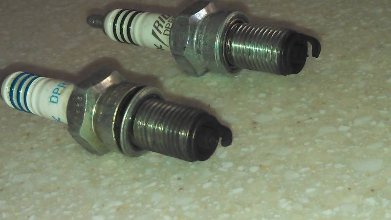

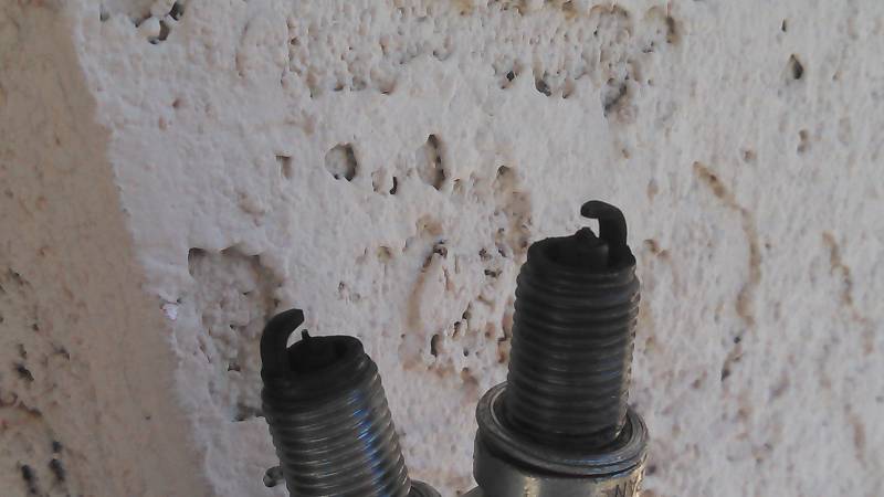

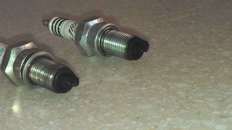

The plugs
here are the plugs that came out of her..
Attached Thumbnails The SAGA continues.....-optimized-plug-1.jpg   The SAGA continues.....-optimized-plug-2.jpg   The SAGA continues.....-optimized-plug-3.jpg   The SAGA continues.....-optimized-plug-4.jpg
