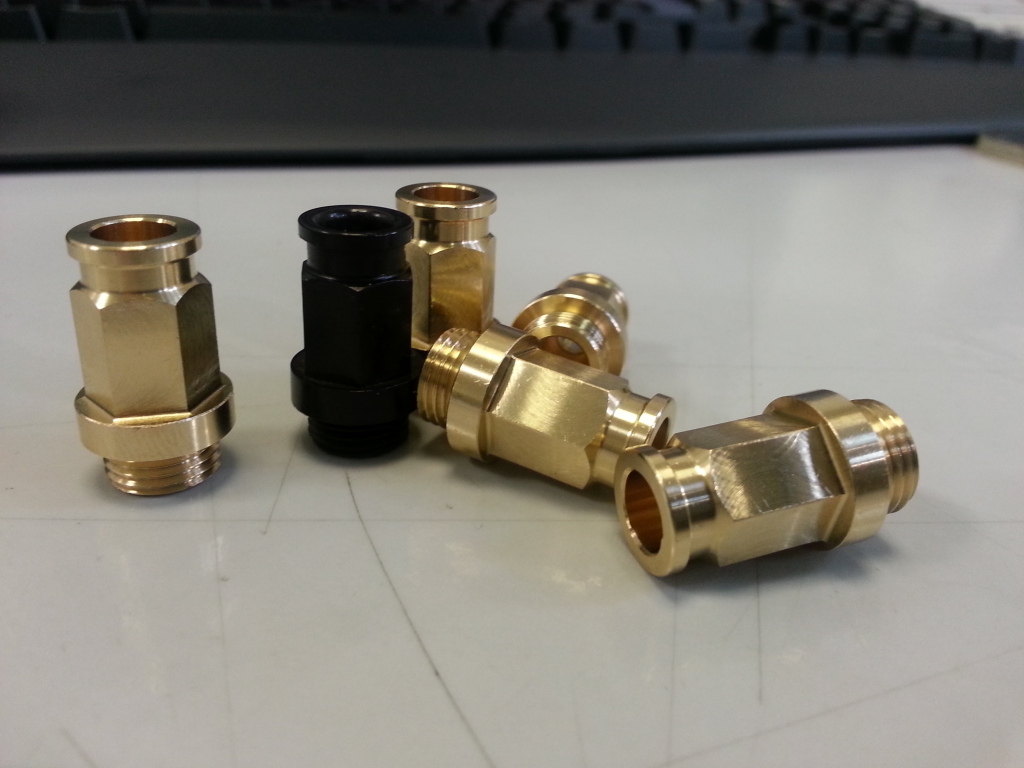

Old Sep 17, 2012 | 07:08 AM
Wicky's Avatar
Posts: 1,707
From: Essex, UK
Looking for these?
http://www.vtr1000.org/phpBB3/viewto...=25686#p220675
