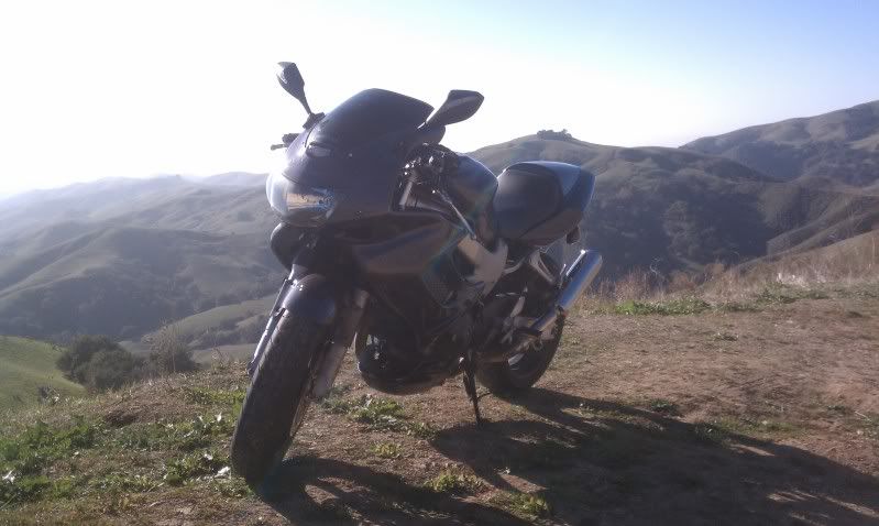

Ya I got VERY lucky.
I took it for a 150 mile ride yesterday and it ran great with the ccts I made. Im at 182 miles on one tank and my gas light just came on. It was all 55-65 mph highway, twisty and some elevation changes but I'm surprised it lasted that long. It felt good to have the bike make me smile after not riding for almost a month.
Old Dec 27, 2011 | 12:39 PM
aja's Avatar
aja
Joined: Nov 2011
Posts: 700
