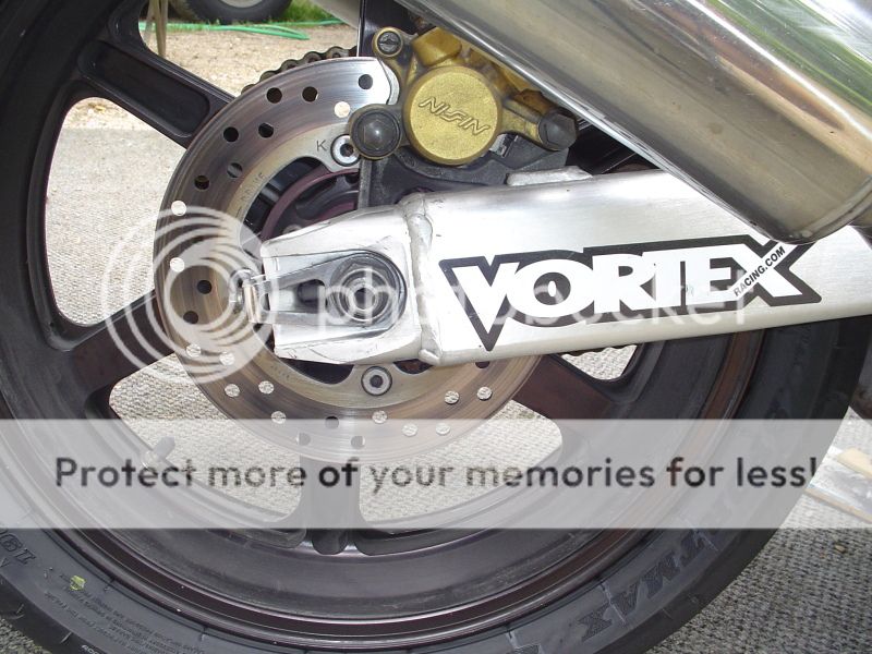

did you follow the fork/front wheel installation procedure or doesn't that apply for cbr forks?
my geometry is radical ***-end high.
I assume your bike doesn't go straight with hands off?
Make sure your tires are seated on the rims evenly(lines equal all the way around), check front/rear alignment(set rear wheel evenly with chain adjusters axle pushed against swingarm, tighten axle, affix long straight pipes or boards to back wheel on both sides.........your front wheel should be centered perfectly between the pipes/boards.
When doing this don't trust the markings on the adjusters to get the wheel straight. You should always sight down the chain and you'll see if the sprocket lines up or is off to one side or the other. Use that as your guide.
agree. i always use the markings as a gross approximation and then measure for chain align/adjustmt. I was suggesting pushing the axle max forward preferably against the swingarm to get the back wheel straight but yes, always have to double check. I've measured from the swingarm pivots back too, but it can get tedious.
