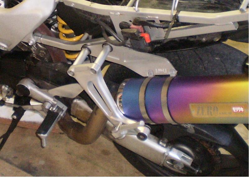

Hey just bought a '99 Superhawk that came with Moriwaki high mount exhaust with the passenger pegs removed. I would like to put them back on, but can't seem to get them to fit. Has anybody solved this issue, or am I hosed?

Well, you can always trade me for my stock header and pegs? JK I don't know the particulars on the Moriwaki's, but typically high mounts totally block the passenger peg mounting points. I may be wrong but I think someone has used CBR pass pegs because they were shorter.. I don't remember exactly. I know the holes didn't line up but it was close enough to do a little grinding to get them to fit. Hope that helps.

It just needs longer bolts for the pegs, and a piece of steel pipe, aluminum, or equivalent. I would have to measure mine but they are maybe 4-5 inches.

One thing I worried about though was the stress on the subframe due to the added leverage when you extend the pegs outward. The subframe twists somewhat with enough pressure, I wouldn't recommend a heavy passenger standing on them.
They are great protection for your exhaust though. My second day on the track I lowsided and the passenger peg saved my muffler from total destruction, didn't get a scratch. The lower midpipe got a scuff though..

Cool thanks guys, and thanks for the pic. I was considering using spacers but wasn't sure if that was a good idea for the same reason you mentioned. But if it isn't affecting your bike I will give it a try. We won't be using the back pegs that often, just every once in the while when the wife is brave enough to jump on the back LOL.

Leverage is no issue, subframe is steel. I have had mine like that for a couple years now, lots of passengers, never an issue.

If your worried about the torque on the sub frame and your mid pipes put your slip ons far enough back you can "customize" your pegs to get them in closer. I'll see if I can find some pics.

I have been considering just cutting the top off of the mounting bracket for the stock pegs and redrilling holes in them so they are shorter and fit with the exhaust, my wife is only 5' tall anyway. Pics would be great man.
