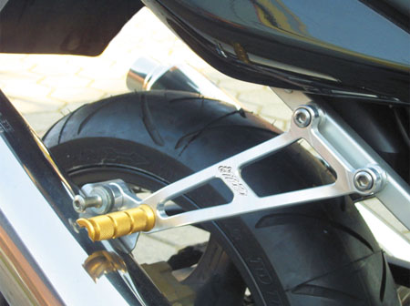

Pricey...
http://www.whaccessories.com/VTR%20Accessories.htm
Attached Thumbnails rear pegs for high mount exhaust-gsgmufflermountvtr1000.jpg

WOW..... your not kidding !! thanks for the site...
