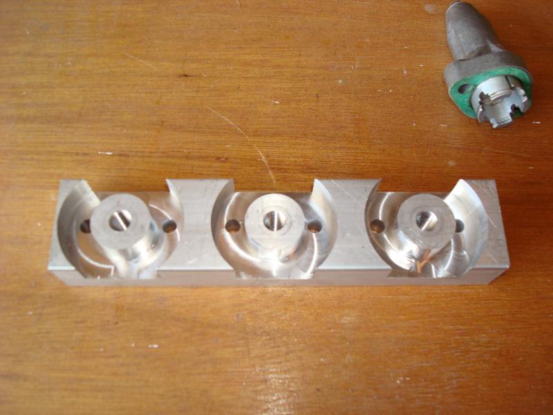

Here's a pic.

Old May 3, 2009 | 09:05 PM
Truckinduc's Avatar
Posts: 1,033
Im using Stainless. Zinc plating will look like **** in a few years.

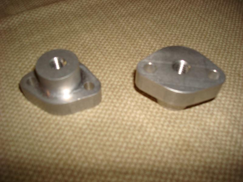

made a little more progress today.
Old May 5, 2009 | 04:11 AM
JamieDaugherty's Avatar
Joined: Aug 2005
Posts: 1,864
From: Fort Wayne, IN
Looking good! You should leave them aluminum. I'd go with an anodized finish if you wanted them to stay looking good. Steel is a lot heavier, although these parts are small it all adds up!

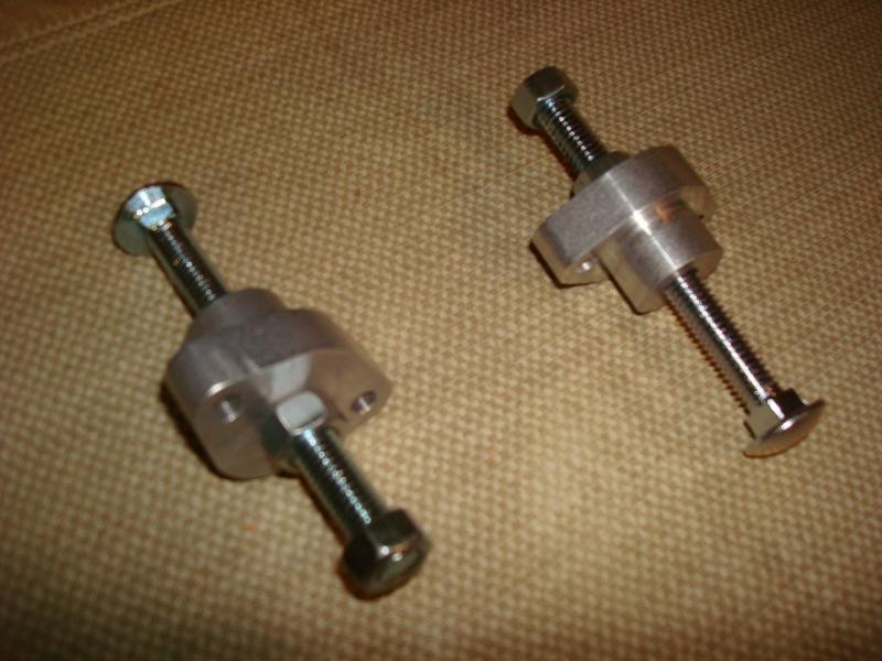

Almost forgot the pic.
Old May 6, 2009 | 09:32 PM
Truckinduc's Avatar
Posts: 1,033
Not going to countersink the bolt heads? Makes adjusting them very easy.
Truckinduc's Avatar
Posts: 1,033
like this
Old May 6, 2009 | 09:47 PM
superdutyd's Avatar
Joined: Mar 2009
Posts: 139
From: Wisconsin
I was going to, but for some reason I wanted to use the stock bolts. Don't know why now. Now that I see it, I probably will c-bore them.
Old May 6, 2009 | 09:49 PM
Truckinduc's Avatar
Posts: 1,033
mine use the stock bolts. You can thread the stock bolts in untill they bottom out to find out how deep you need to go.
Old May 6, 2009 | 09:53 PM
superdutyd's Avatar
Joined: Mar 2009
Posts: 139
From: Wisconsin
Never thought of that. I'll have to try that.
