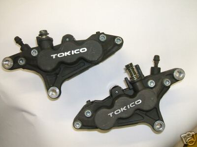

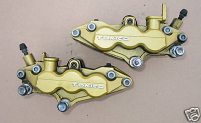

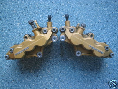

Hello all. I am about swapping in GSXR Calipers in my SH, now i have 3 offers and all 3 vendors claim the calipers are from either a K1 or a K2 model, which would be ok.
The only problem is, all 3 calipers seem to be different on the pictures (and i dont mean the color.. ).
Can anyone here determine which calipers would be ok to buy?
For me the black calipers seem to have a different bolt distance, but i can be wrong.
Any advise is highly appreciated. Thank you in advance.

The first one and the last one (not the black ones) look identical to me.. they are turned to different angles, but look like the same part.
The black ones don't match the other two.
I am fairly sure either of the gold ones are the right ones, but it is hard to tell from just a picture.
(one has the banjo bolts and not the caliper bolts, and the other has the caliper bolts and not the banjo bolts installed, but otherwise they seem to be the same.

Yes that is exactly my opinion too. The black calipers seem to be different, the golden seem to have at least the same bolt distance. I contacted the vendors for the measures, but no response yet.
Thank you.

The calipers in the first and last pictures are identical and it's what you should buy. I have them on my SH, and they bolt on directly. If you do this mod, I would reccommend installing also a larger MC.

The first and last photos are the correct calipers you are looking for and are only found on the '01-'01 GSXR1000. The middle set is another six piston setup that can be found on many models... GSX1300R, GSF1200, just to name a few.
