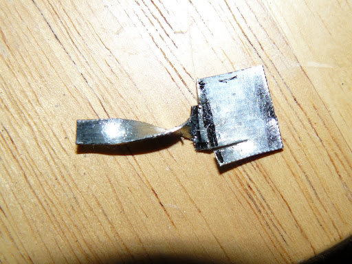

Hi all.
On my way home from the eastern holidays my bike started "ticking", the ticking increased when i raised the rpms. Rode carefully for a couple of minutes, not sure what this sound was (I was in a line), then the bike died. It died the same way it dies if it runs out of gas, not sudden, but slow and surely.
Tried to crank it, then it sounded like I had a loose chain inside my engine, a terrible sound! I don't own a garage or the tools to open it up and check for myself, so I got it to the local Honda workshop, and they gave me the news today. He confirmed the CCT as the failing part. A lot of bent valves and damage inside the engine. He said it looked like I had it running for a while after the CCT actually failed, and this messed up a lot of different parts.
I am going there to see for myself, and note the damages, but he advised me to buy a new engine instead of a rebuild. He said the rebuild would cost me about $5000 in parts and work hours...
Here is the bike in question, as you can see, CCT is not one of my mods...
https://www.superhawkforum.com/forum...41/#post235136
What should I do? What is my options? It is not so easy to get hold of an used engine in Norway, though I will happily pay the shipping!

As long as the piston wasn't damaged by hitting the valves, a replacement cylinder head complete with valves is all you'll need.
Keep an eye on ebay, they pop up occasionally, although front heads are rare as it's usually the front that lets go.

Are you serious? If that's the case, I'll might survive this after all!
It is probably just one of the CCT's that failed, and then it's proably just damages on one of the heads, right? (because of the independent cam chains?)
From what i could tell, the mechanic did just open the top cover on one of the heads and had a look around, so what should I ask him to do?
Is this a good approach?
- Fully open both heads and check for damage on pistons in addition to damage on valves.
- If there's no damage to the pistons, change the head / two heads if needed, and get it running!
- If there's damage to the pistons, and / or small pieces of metal everywhere, buy a new engine?

Sorry to hear about your cct failure If it were me I'd find a good used low mileage motor and just swap it out.
Here's an example of one in Germany: Find Honda VTR1000F Firestorm SC36 Motor on eBay Global Buying, with worldwide deals on items in all your top categories

Would you not take the chance of just changing the head (I assume changing the head on my old engine is cheaper), because of the possibility of more damage deeper down?

Yes, there will be a HIGH probability that you'll have metal from the chain slapping the inside of the head that circulated in the oil. The best way to check is pull the oil pan and inspect the crevices in the bottom of it and check pump's filter foot for metal hiding in it.
If no metal pieces can be found then just replacing the head will work fine, otherwise you may risk another engine failure after replacing the head due to the metal contaminated oil reaching bearings and/or tranny...

I have given this some thought, and I think it's the safest option to change the engine, though it's not necessarily the cheapest one.
But consider that the new engine is two years newer, and has 36000 less miles on it!

is this the tool you're referring to, Tweety?
before:
after: (whoops):
That would be the one... But I'd call that poor quality control...
BTW, why anybody would replace with stock CCT's are beyond me though...

i took the top of the rear apart to look for source of nasty clanking. once i get the cam chain back on with both RE and RI and the cams aligned correctly at R TDC i'll ask myself the following questions. 1) "why didn't i just measure the valve lash?" 2) "why did i remove the cams?" and then i spray mace in my eyes as penance for my sins.
here's a nicer one. i'm getting better.

Make your own if you're a cheap *** but change it now!
It seems like every month there is a CCT issue. I don't know about you but why take the chance? Just spend an afternoon and change them out. If you don't want to spend $100 on the APE Bling.... Spend $10 and make your own. Works the same. Regarding my write up, I realized there are some technical errors in the piece but it's all there. If you take that and also read Lazn's piece you're know just about the same as any Honda tech regarding CCT change. Just do the damn thing and let's not have anymore of these thread come up. We need every VTR on the road!
Make your own here:
https://www.superhawkforum.com/forum...ual-one-22711/
when my rear cyl began clanking and i shut down the motor and had the bike towed to my garage, one of the first things i did was order a couple red APE CCTs. i assumed that my rear CCT had failed. i got the APEs in the mail late last week. i'm currently back-tracking on the sprocket removal so that i can get an accurate reading of valve lash at TDC. in order to do that i need to release the tension on the OEM CCTs.

BTW - That special Honda tool can be replaced with a flat head screw driver....
it's much more fun to make the special little tool. ? . ?
i wish i could figure out how to make that damn banana stand still!
+1. Making the special little tool is the most fun part of the project. (apart from the fact you get to keep riding because your valves aren't AFU..)
