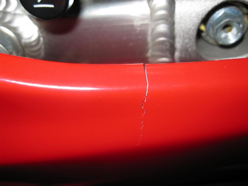

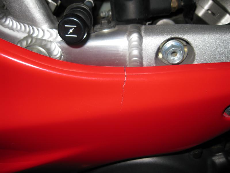

This weekend while working in the garage I caused a crack in my fairing . What's the best and cheapest way to fix this.

First thing is to drill a small hole just beyond the extent of the crack to stop it going any further.
A search of the forums/google will bring up past threads/info on plastic welding, v in crack , sanding, blending in spray etc

Take the fairing off and plastic weld from the back. (Use a low wattage soldering iron and zip ties for the cheap way)
Then if you are careful you might not need to repaint.

I'v got a stress crack in almost the same place, but about 1/4 as bad - it never made it past the horizontal. To stop it from geting worse I took a piece of plastic (the plasic tie from a loaf of bread) put couple drops of epoxy and glued the plasic over the crack to hold it together. From the outside it is impossible to see the repair.

Methyl Ethyl Ketone. use a q-tip to get a little into the crack squeeze together for a few minutes. It's now chemically welded. you can also use abs glue or make your own by melting abs (shavings are best) into the MEK. Legos are abs and make wonderful reinforcement with a little home made abs glue to hold them in place.

+3 ABS glue ,The crack you have is common, mine was cracked just like yours . do not drill the end of the crack!
Just sand the back of it to expose the abs and if to have a hugger on then use the plastic from the stock mud flap to cut a small square to span the crack with.
Youngjester, why no drilling of a hole to stop the crack from getting bigger?
Old Mar 11, 2010 | 06:06 AM
Well, if you do the repair right you won't need to touch up the front and the crack will not spread since it will be repaired... And drilling a hole makes it kind of necessary to fill the hole and then sand and touch up the front...
A large crack in a high stress area where you don't have the option to repair it without messing up the front, then yes, you should drill it... Here I'd try to avoid it if possible...

Drilling the hole is a technique used in glass. I beleve that the crack was made by stress when moving the bike, not from vibration . Drilling will not help in this situation. It is also cosmetically bad.
We have a shop here in Hayward "Cycle Salvage" , the owner Chris is a magician at plastic welding , I took my plastic to him and he repaired it good as new for a reasonable price.
