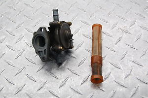

It's attached to the petcock.
Take the tank off the bike. Remove the two bolts that hold the petcock, lift it and pull out the mesh filter attached to it.
