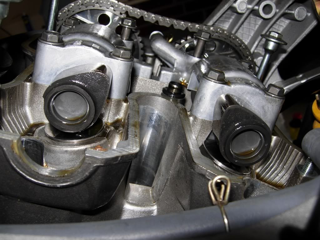

Your rear cam lobes should look like this when at TDC:
Old Jun 9, 2011 | 02:29 AM
3amta3's Avatar
Jack of all Master of non
Joined: May 2011
Posts: 297
From: Jacksonville,fl
3amta3 is on a distinguished road
they do look like that but they where adjusted on the wrong stroke. you can turn the engine 3 revs and have different locations on you valves so i am sure i just adjusted at the wrong stroke of the engine. simple fix, atleast it is the rear cylinder and not the front one. i guess this will teach me to not follow directions next time.
