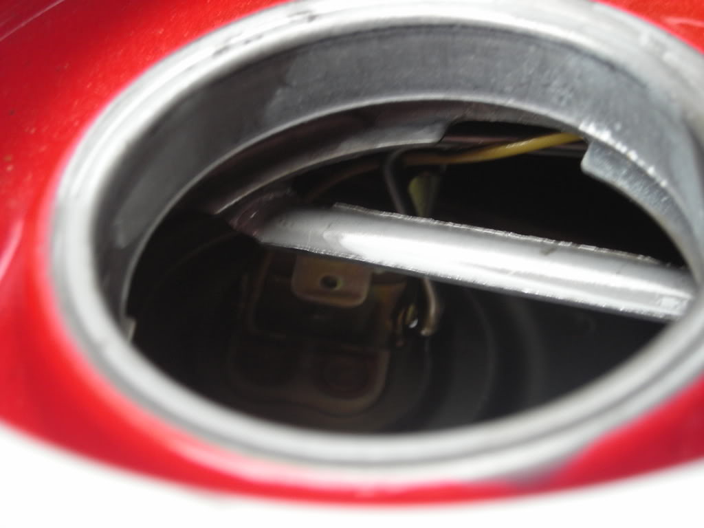

Gas gauge question on '02
I picked up an '02 yesterday from a friend of mine. The only issue with the bike is that the gas gauge always reads empty, first thing I did was check the plugs under the seat (which I had read on here)- found that the one coming from under the tank was loose, but after snapping it together it didn't change a thing. Because the bike has had the tank replaced I was able to look at the gauge assy. in the old (empty) tank and there appears to be a light aluminum piece that I'm assuming is the "float", but when I look at the assy. in the tank that's on the bike this piece is missing. It's just the brass frame with a couple wires on it, and there doesn't appear to be any moving parts. Am I correct that this is indeed the float and it is missing from the tank that's on the bike? This is what it looks like on the tank on the bike (sorry it's not a great pic)- any thoughts?
Old Apr 26, 2008 | 08:14 PM
Posts: 2,223
Take the sender off the old tank and "new" tank and compare them. If the new sender is missing a piece, swap the old for the new and see if it works. Prior to the gas gauge equiped VTRs (98~01), the sender only triggered the RLOD and may be (probably is) different. You have nothing to loose in trying.
Old Apr 26, 2008 | 08:45 PM
Both sending units will look similar when viewed through a dark filler neck. reach in and try to move the float about to see if there is actually one there. If there is, with the ignition off, hold the float up. Then while holding it up turn the ignition on... it should read "full". There is a very fine wire on the sending unit that could have become disconnected from it's soldered point.
Old Apr 26, 2008 | 11:02 PM
Posts: 2,223
Do they really use a "float" on the 02 and on? The pre-02 have a none moving sensor on an arm that when "dry" the conductivity is broken and triggers the RLOD. BTW, you can bend the arm up or down to adjust how much you want in "reserve" for peace of mind.

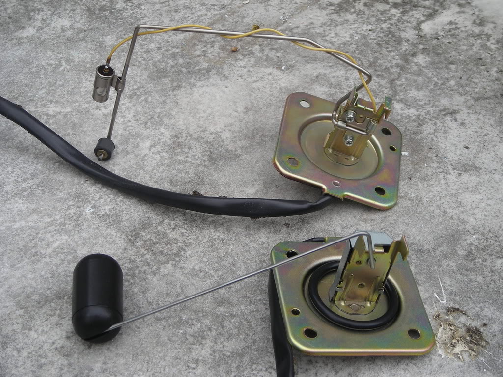

Old May 3, 2008 | 06:57 AM
Timmybung's Avatar
Joined: Apr 2008
Posts: 26
From: Southern NH
Timmybung is on a distinguished road
Pulled the gauge assy. from the original tank today (see attached picture). Will be installing it in the tank on the bike, hopefully that will remedy the situation. A question though- by removing the two bolts on the front of the tank can I then hinge it up (like lifting a car hood) enough to remove/swap the gauge assy, or will I need to remove the tank completely? Either way I'll need to wait a few days till it's nice out so I can ride it and burn some gas- tank is at like 3/4 full now.
Old May 3, 2008 | 09:54 AM
I'm sure you can if your fuel level is low enough.
Old May 3, 2008 | 10:44 AM
I'd imagine you will have better success removing both front and rear mount and laying the tank on it's side... I think there should be enough slack in the hoses for that...

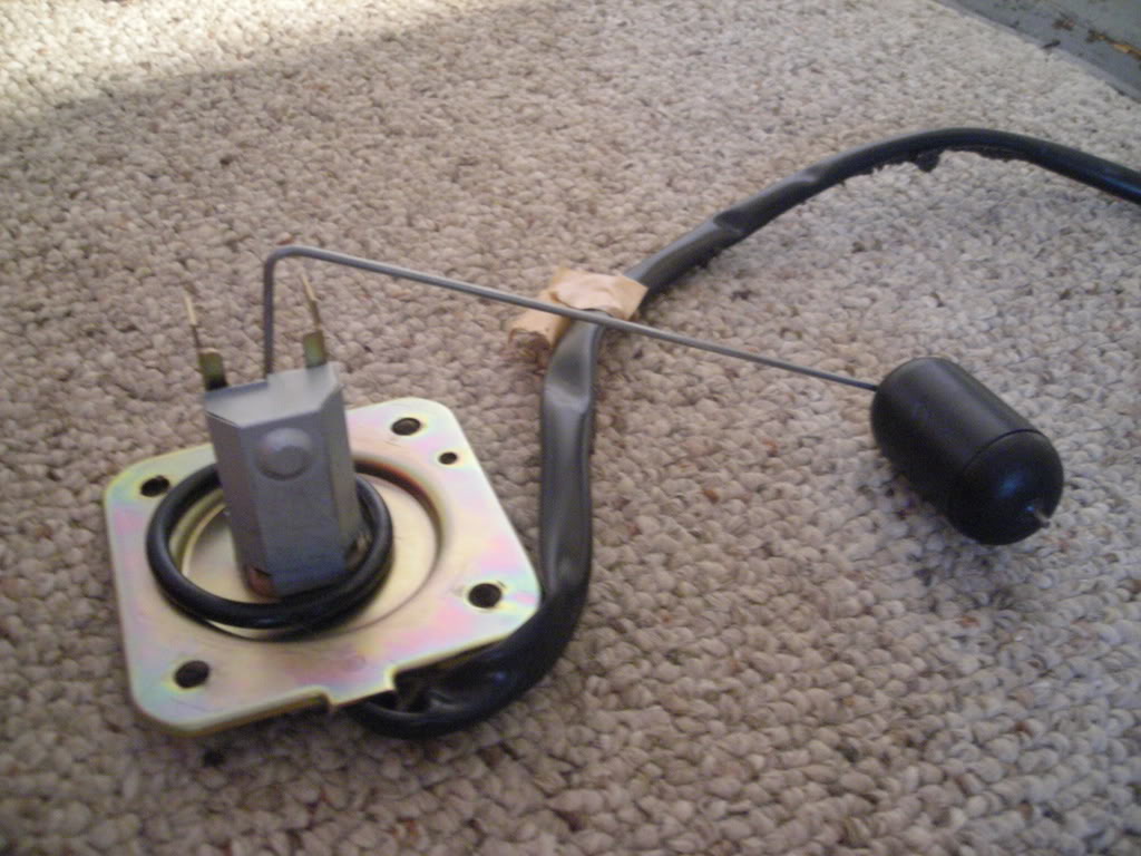

Old May 9, 2008 | 07:22 PM
Timmybung's Avatar
Joined: Apr 2008
Posts: 26
From: Southern NH
Rode a bit yesterday, so today the tank was practically empty and I finally got a chance to make the swap. Took off the two bolts at the front of the tank and raised it up like a car hood, used a stick to prop it up- plenty of room to swap the fuel gauge assy. Confirmed my problem- the tank on the bike isn't from a newer bike with the newer fuel gauge (see pic). Installed the right one, problem fixed. Wish they all could be this easy.
