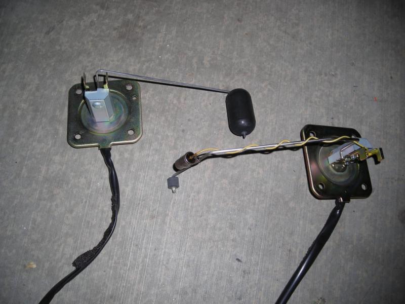

Are all VTR gas tank identical??
After putting a newer style sending unit in my tank I have discovered a possible issue that others have described. It appears the float may be hitting the vent line inside the tank preventing it from displaying the entire range of gas. If you happen to put the float above the vent line you will get the upper range and if you put it below it like I did you will get the lower range so you can see when you are running out.
Is this confirmed that the gas tank are different in the 98-00 years as opposed to the 01-05? I may have also put the float in incorrectly but I put it in the way it seemed it should be placed.
If you loook at this pic of the two units you can see they are oriented differently. I just looked at Ron Ayers and it appears the wire oreientation will be different and the float direction is the same, pointing backwards. It also looks like Ron Ayers pic shows two types of floats, one has a float and a reserve sensor on it?
Any tip on what direction to bend the float and where the vent lines run inside the tank.
Attached Thumbnails Are all VTR gas tank identical??-fuelsensors.jpg   Are all VTR gas tank identical??-tank.jpg

DON'T MEAN TO JUMP THIS THREAD, BUT DO HAVE SIMULAR QUESTION. OFTENED WONDERED IF THE FUEL LEVEL SENDER COULD BE ADJUSTED. WHEN I TOP OFF MY TANK IN LESS THAN 10 MILES IT DROPS 1 INCREMENT. WHEN I GET TO THE LAST INCREMENT & FILL IT BACK UP, IT NORMALLY ONLY TAKES 2.7 GALS. WHAT'S UP WITH THAT?
Yes... Just bend the arm on the float a bit for adjustment... BTW I'm pretty sure you're supposed to run it till the last segment is blinking, that's the "reserve"...
I'm using a VFR float/arm so I had to "calibrate" it myself...
The adjustment should be just bending the arm of the float. Just like a toilet float if it's not filling high enough. Sounds like the arm just needs to be bent upwards. Are the components stock or did you put the sending unit in the tank.

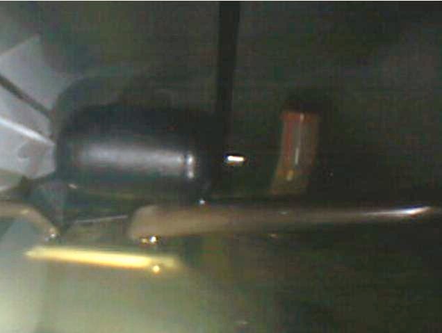

Got some video
I had an old cheap web cam I got off craigslist for 8 bucks a few years ago, I guess it came in handy. Rigged the bulb off my flashlight onto it and shoved it into the tank.
You can see the float is resting on top of the vent line on the left side of the tank(right side of video). I think I see where a bend would resolve the issue. I just want to make sure I get a left/right bend and not an up down to prevent false readings.
Old Apr 27, 2009 | 10:46 PM
yruyur's Avatar
Joined: Dec 2008
Posts: 507
From: Arizona
Here is a screenshot I took of the video that pretty much shows the problem area. Any ideas of where the bends should go?

Well we got the fuel sensor to show the entire range. We shortened the float arm by half an inch. Drops a little dramatically for the first three dots as I have heard from others as well. Mine may be a little more extreme as the arm is shorter
first mark .6 miles
second mark 9 miles
third mark 23 miles
I wish someone here had a newer tank so I could get my camera into it and take video of it to compare the vent lines and the float location.
