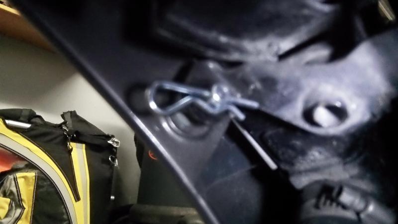

After a few days of enjoying very stable fairings, it appears I've lost one of the clips. Perhaps the bracket wasn't aligned just right or I came down from a wheelie too hard?
Anyway, rather than pay BikeBandit another $1.26 plus $7 shipping, I zip-tied it. I'd say it gives about 85% - 90% of the stability that the OEM Clip does. I'll probably go this route from now on.

My solution to this problem
Attachment 17003
That's pretty sweet, reusable too! Where'd you get that fastener/pin?
I sell them in my line of work.

Jack Flash sent me some of his karting "nassau panel clips". They worked out really well!
Just drill out the existing bracket holes to 3/8 or 7/16 (or 10 mm for the metric folks) and squeeze, stuff, and cram the rubber grommets into their new home.
The nylock nut and washer go on the inside of the fairing/cowl lip and really stabilize the lower fairing much better than those cheap plastic push-pins.
