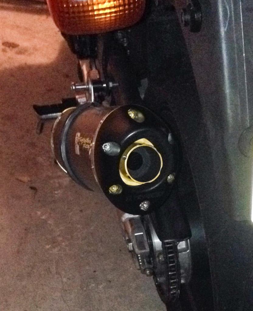

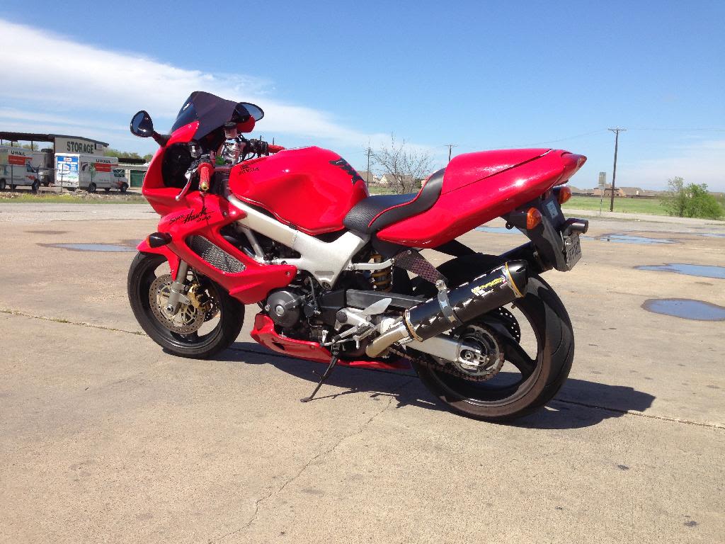

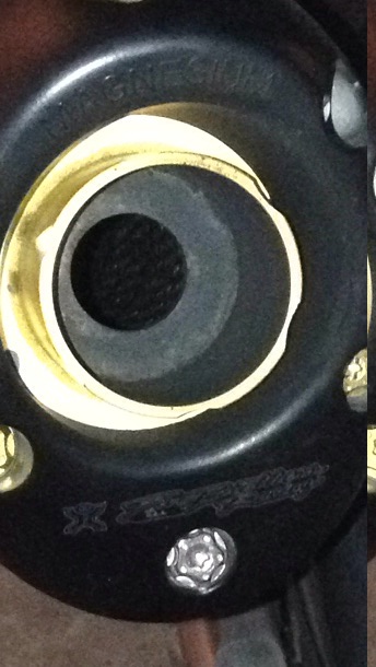

Some pictures of the appearance when installed.
Sounds quiet, looks awesome. (Didn't have them in for this pic)
