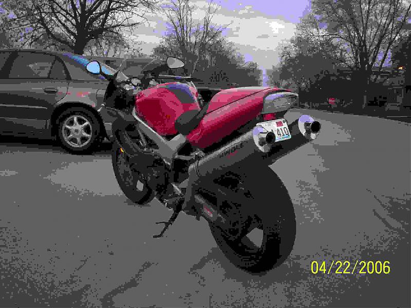

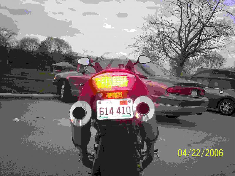

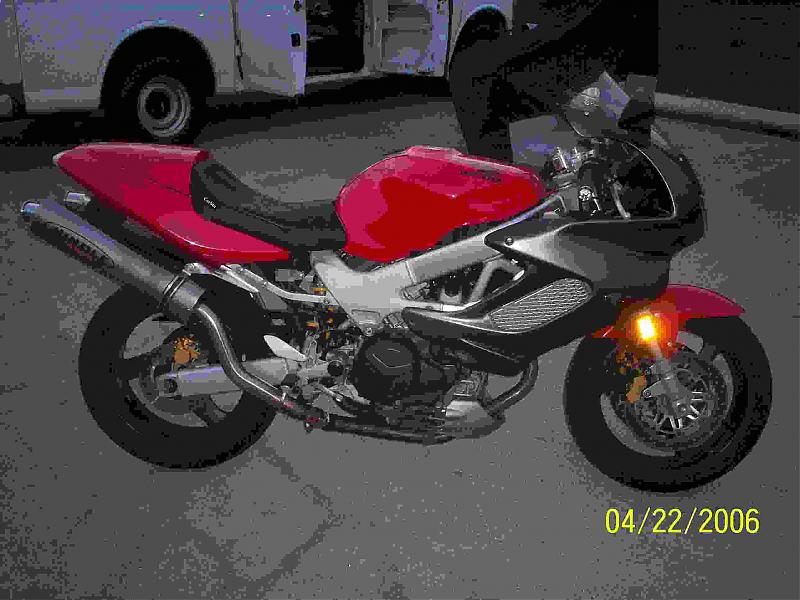

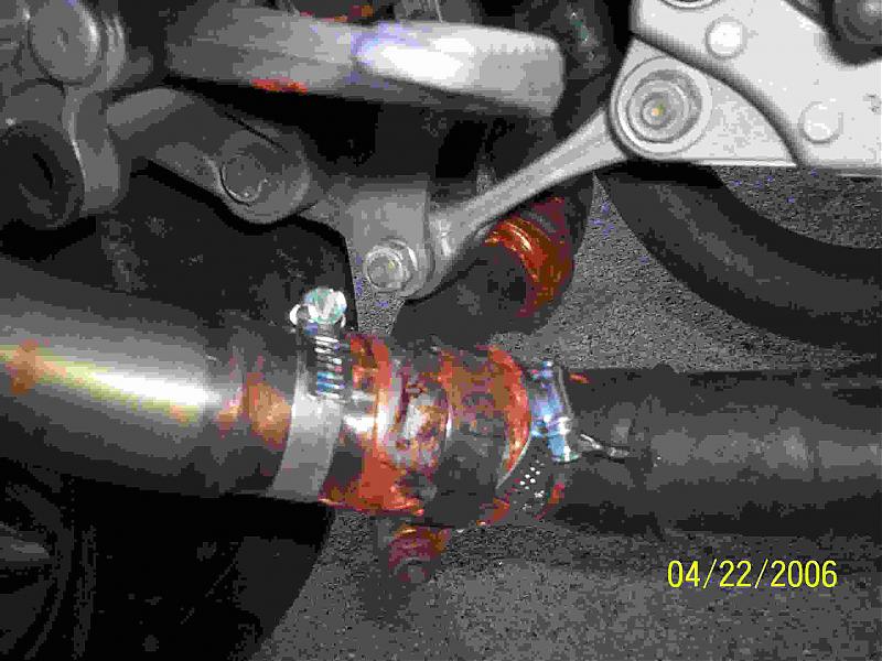

it can be done depending on what pipes they are. I have hindle highmount titaniums for an rc. didn't know for sure that they were for the rc instead of the hawk for a long time. I just thought I was missing some connecting parts. anyway, it can be done but it will be a battle. I finally got mine to work but only after I resorted to using car exhaust clamps, as well as a car exhaust extension piece. (cause one side is longer than the other) and lots of synthetic heat resistant gasket goo(can't remember the name at the moment). its really more trouble than its worth. the only reason I persisted was because I got them off ebay and I couldn't afford to get another pair after I bought these. but now they work great and sound even better. but they still don't sit exactly even on both sides.

I don't know if you'll be able to see or not but there are marks on the cans from where the clamps held the pipes on whatever bike had them before mine and as you can see, its not the same. the connection pic looks uglier than it does now. instead of the 3 clamps you see, now there is only one car clamp. the stock clamp was way too weak to lock down the pipes. it might look like a mess but trust me its solid. you can see the car exhaust extension between the midpipe and the header. as for the tail I got the cans pretty even but not perfect. and it is not getting any better than this. I've tried everything and if they aren't uneven like that, they won't hook up underneath. after alot of fiddling, they don't leak, and now the bike is jetted for them so it runs great. they sound good too even if they weren't meant for this bike. but like I said. it was a long long battle sorting out all the little issues.
