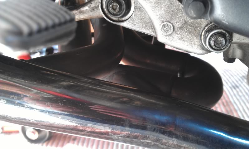

I will get a pick of mine up quick and show you what i have.

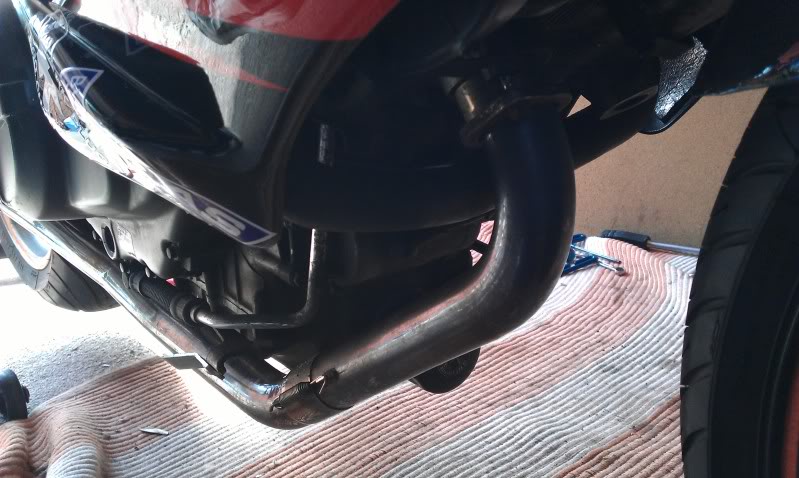

Old Aug 14, 2012 | 01:46 PM
pchrist's Avatar
Joined: Feb 2012
Posts: 245
From: Eastern Iowa
pchrist is on a distinguished road
Old Aug 14, 2012 | 01:50 PM
That is a very stock looking header... So I'd say it's a 99% certainity that you have slip-on's and not a full system...

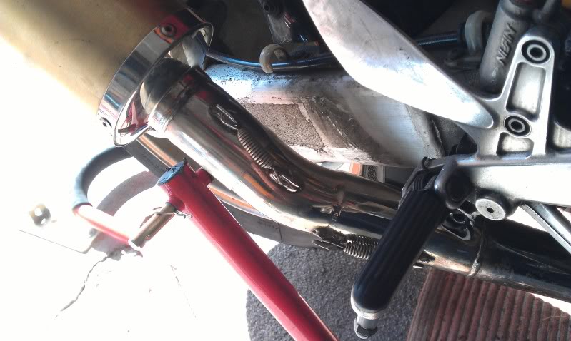

you have an older style yosh slip on, similar to what I have on my rc51. I contacted yosh in regard to the slipon on my rc because I highsided some yrs ago to see if they still make the same style so that I could replace just the one side. They no longer make these style where the can and link pipe are all one solid welded piece. IMO they are much more durable since the can/linkpipe didn't bend from the incident. They now sell them with a removable can and have them attached with springs to the linkpipe.

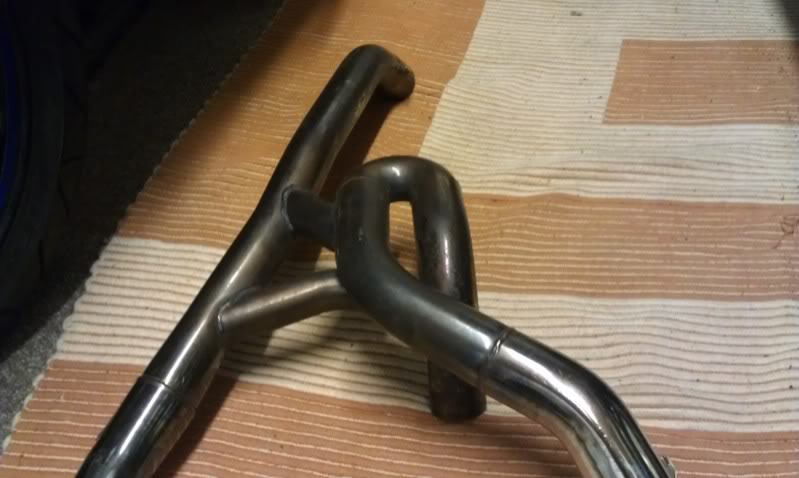

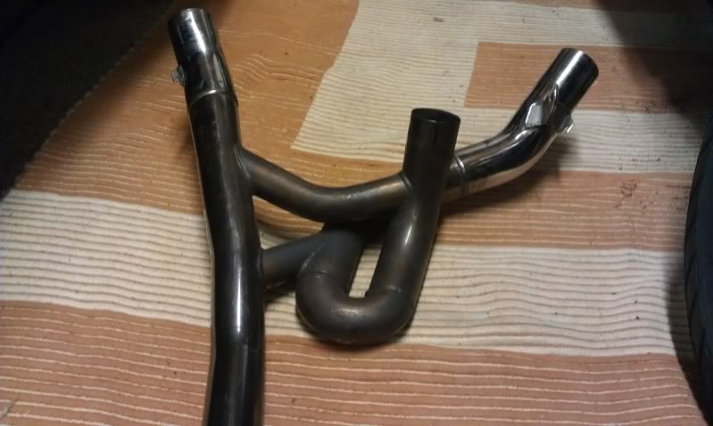

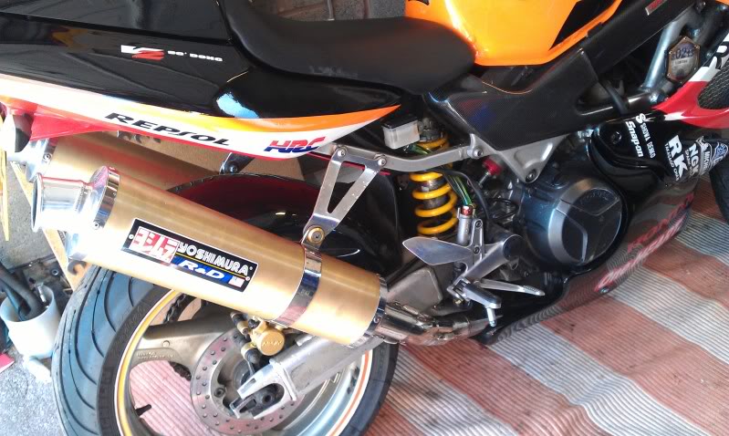

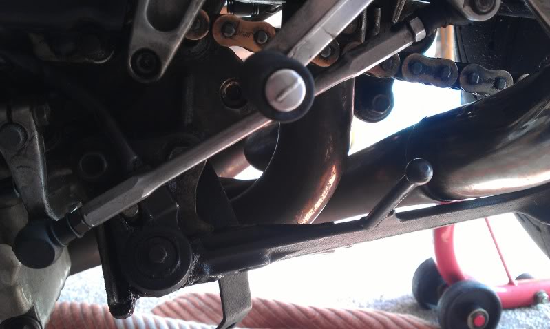

here are my Yoshi R&D headers + cans just for refernce

another set of yoshi cans and headers

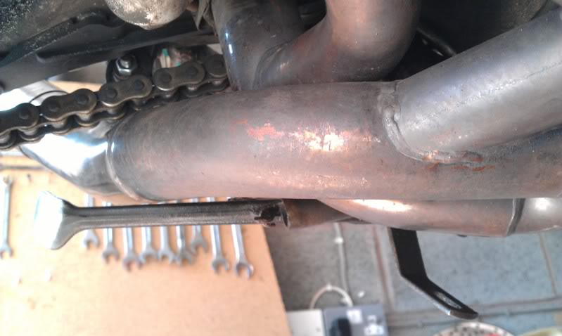

Here are pics of my very old Yosh pipes. These were apparently made in the very early days only.
pics of the RC51 and VTR for reference
