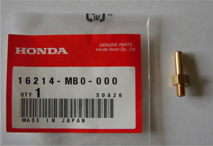

So, I'm hearing about this screw that you install on your front carb and is flared on the end to allow hook up of hose for syncing carbs. Anyone know what I'm talking about? If so, what's it called? Called 2 Honda dealers. One had no clue, the other said it's about a $60 part. I'm hearing it should be about $4. If I had a name for it, perhaps I could better explain to them what I'm looking for. Thanks guys.

Steve, it's just the vacuum fitting for the rear carb. it's called a boost joint. part #16214-MBO-000............. $4.00

They are different. The "T" joint looks like a T. The part you are referring to screws into the front cylinder and is called "Joint, Boost", someone in Japan has a good sense of humor. To hook up a hose system to quickly sync your carbs you need both. There is a KB article on it somewhere.

The T's are actually for the existing line so that you can get a reading for the rear cylinder and still have vacuum to the petcock.

Thanks everyone. Having the part number makes things much easier.
