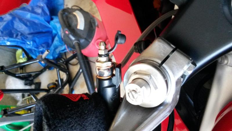

Was away for 3 weeks....finally got the clutch working good.
Further inspection showed the PO decided to store ketchup in the master and slave cylinders. I went with the nuclear option: Rebuilt the master, cleaned/polished the slave (new seal) and replace stock line with SS line.
Bought a banjo bolt with a built in bleeder screw... worked great for getting the air bubbles out near the master cylinder.
Clutch is engaging and disengaging like it should now.
Attached Thumbnails Clutch Slave/Push rod-20150503_105010.jpg
Where did you get that banjo if I may ask

www.PegasusAutoRacing.com
Part # 3242-022 Single Banjo Bolt with Bleed Screw, 10mm x 1.25 Thread
$14 for the part (not bad)....but they charged another $10 for shipping which didn't seem fair for such a small item. $24 total.
