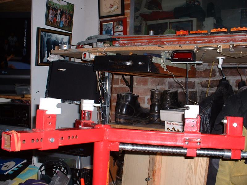

On my HF unit I fabbed some 'jojo" blocks to hold the rim out of delrin.(firm grip, no scuff) You can buy it in bulk from mcmaster-carr and hacksaw it.
The hf unit has a really good bead breaker so no prob there, but you need some plastic rim savers and a c clamp with innertube over it to speed things up.
