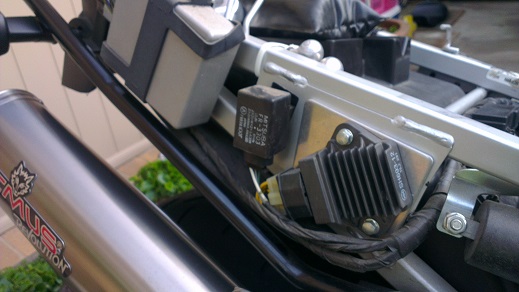

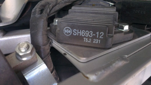

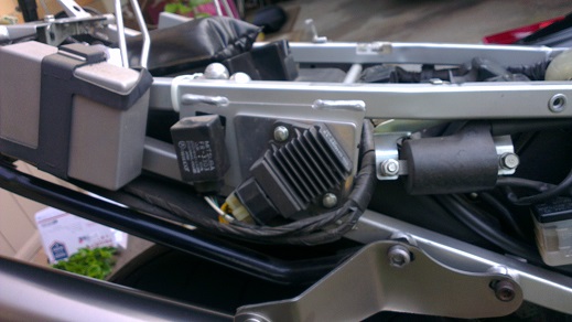

Breathing a sigh of relief.
After identifying what i felt was a R/R issue at idle I searched these fine pages for a remedy finding the well documented MOSET retro-fit.
On receiving my roadstercycle.com kit I was shocked to find what I thought was a already exchanged MOSFET R/R in place.
Ok ok before you all start, yeah I probably would have been well served to actually open my tail up and see what was there already. Point taken, however the previous owner who had the bike from new told me it was totally stock and everything I have opened or investigated supported that, until this afternoon when the pic in the manual and the R/R looked different.. looked like it had already been changed?!
Superhawk Forum to the rescue. Indeed my 05' had a different 'finned' R/R in place of what the Haynes manual pictured. Once again thanks to forum members who have walked this path before I and asked all the relevant questions I now know the models late in the run had finned R/R's, however not MOSFET..
Outcome:
A: Breath again..
B: You have not wasted $130 on a part you don't need.
To add my 10c I'll include the pics I took so other can identify the same immediate concern I had... and in turn breath and feel safe they have not wasted there money.
Attached Thumbnails Regulator/rectifier-imag0083.jpg   Regulator/rectifier-imag0084.jpg   Regulator/rectifier-imag0085.jpg   Regulator/rectifier-imag0086.jpg

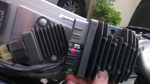

And finally..
The new MOSFET F/F alongside the OEM job.
Yes they are right alongside each other.. that is the actual size difference with the kit from roadstercycle.com!

Old Sep 25, 2013 | 06:54 AM
Your bike has an updated OEM finned diode based R/R.. Prone to failure just like the earlier model ones.
Use the MOSFET R/R and kit you purchased... after removing the old R/R, toss it in the bin.
Old Sep 25, 2013 | 07:41 AM
That kit you bought looks to have the higher finned MOSFET R/R- you will likely have to grind some of those down to fit the plastics back on (If I'm seeing it right). They used those in a couple of Yamaha's but I forget which ones. Just to forewarn you!
Old Sep 26, 2013 | 03:25 AM
Blackbetty's Avatar
Posts: 42
From: Canberra ACT Australia
Blackbetty is on a distinguished road
Cheers for that, was wondering how I Was going to fit it to be honest!
