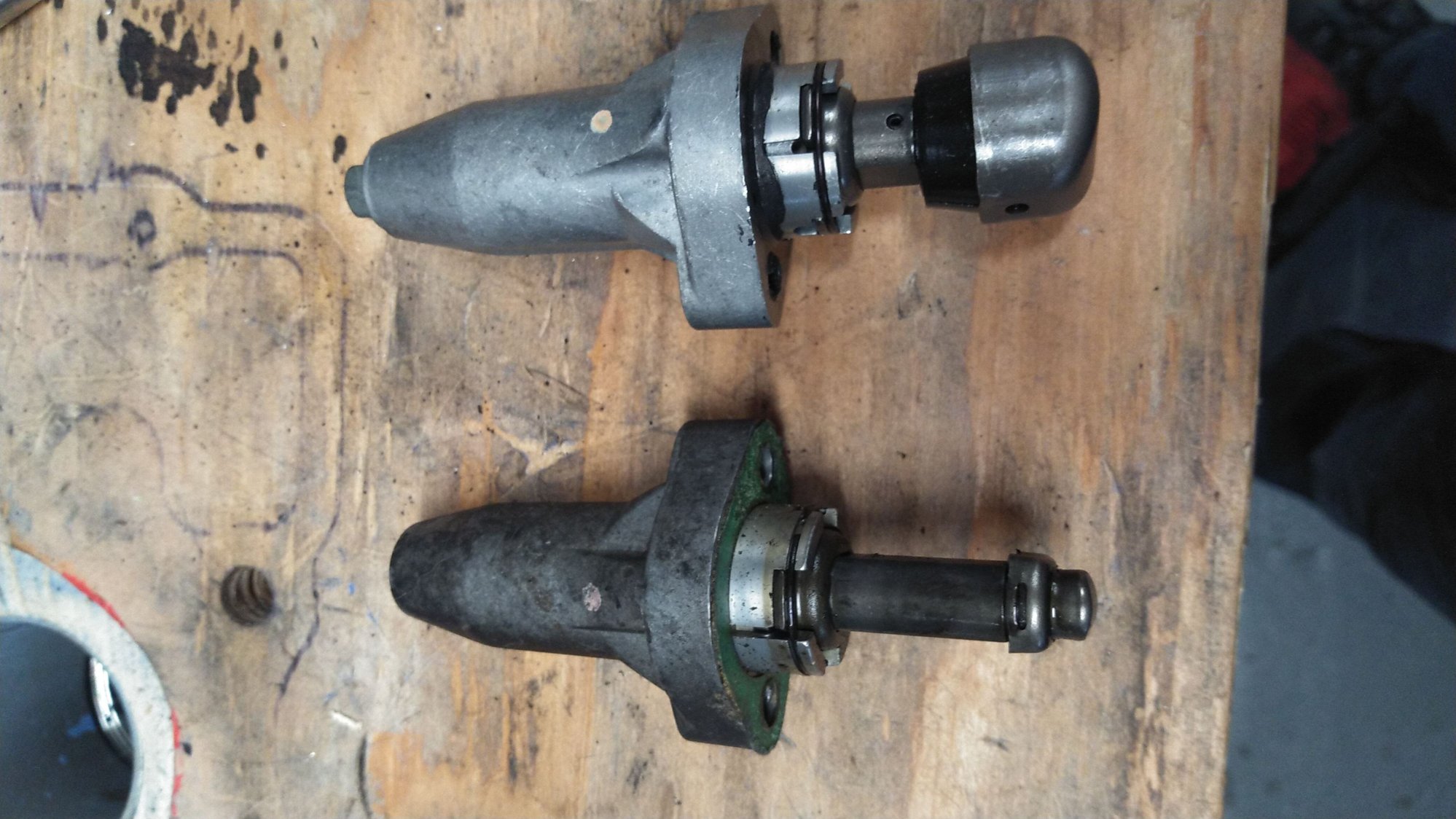

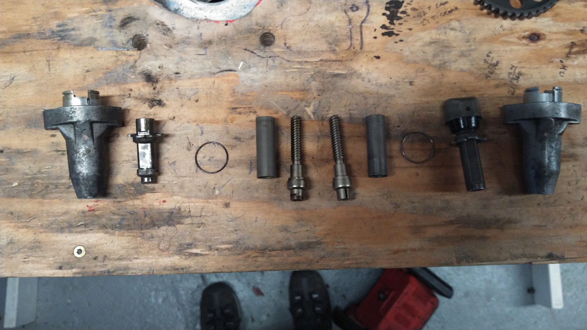

For what it's worth, I just started making the Superhawk/Firestorm tensioners after someone here contacted me. Up to this point, I"ve done mostly Kawasaki tensioners since I had to make them for my own bikes. No one listed them for my bikes. When I made one I made five and started selling them. That was 2 years and over 200 tensioners ago.
The VTR tensioner kit has both tensioners with gaskets for $65 plus shipping. If you are interested feel free to PM or email me from this forum. I can fill you in on them

You won't find me BSing on this. I've just started making them for the VTR and have sold three sets, two waiting to get the gaskets, but none installed. I am sure we will all hear the results with the first installations. Of course that is also how I started with the tensioners for the various Kawasakis too. The only ones I had immediate knowledge of were the ones in my own bikes. Of course I can give you a lot of references if you wish, but I believe they are also printed up in the other thread.
The one on the KLX250 was remote engineered, working with a rider in Austin Texas and me in Delaware Ohio. Several pictures, some measurements, some phone calls, and some reverse engineering measurements done from scaling the pictures resulted in a tensioner prototype that worked exactly as it should. The compound angle offset of the thru bolt made it a bit of a concern, but we did good. The VTR with the 3mm offset was relatively easy in comparison. I'm pretty confident in the results that will happen based on the Kawasaki experience. Now I just need to find out about the thru bolt length by long distance experience. I just learned that on a different Kaw unit, using a 90mm bolt where a 110mm was needed. I shipped out the new longer bolt after a quick phone call from the rider, no problem.
The thing is it isn't that the part is rocket science, it is the cost and effort of making them yourself. If I had to hand cut, thread, and finish each one I did I wouldn't be selling them. The first dozen were hand cut and finished with three or four scrapped out with angled threads. My fingers got quite hot with the heat generated by cutting the bodies with a band saw - aluminum is very efficient at transferring heat! That is purely a pain in the butt. By working out a good method for manufacture I am able to make them at a low enough price for a rider to skip the headache of making them and help the rider who either doesn't have the tools, time, place, or skill to do them.
I care enough about doing right by the guys that I had two packages misplaced and I send out new ones without any reservation. I got one back because the house address was 26 instead of 25 and it took a month and a half to return from the UK. The rider in Canada got the other after a lengthy delay in customs (no notice of that though), then got the second one. He actually decided to pay me and sell the other one rather than bother to send it back (I was going to split the return shipping with him), I guess he liked the result of the one he installed. Another rider didn't like the fact that a manual tensioner will have light chain ticking when cold, quieting down after thermal expansion, and wanted to return the part. I refunded him and paid the return shipping too.
So I'm trying to do right and treat riders like I'd want to be treated. I will only post a comment if it is in a thread about the tensioners, not just blatantly spamming everything. I will also say "if it ain't broke, don't fix it" which I often say with the Kawasakis because they don't have catastrophic failure, they do it over time. Sounds like the VTR is in a different situation though. They can break big time.
I hope I've aleviated some concerns here.

I'm one of the first UK customers who've ordered a set from klx678, not for for me but for a friend who's returned to biking after having rugrats and got herself a storm (guess what she had before sprogging..) anyhow, she got herself a '98 with OEM CCTs and having myself gone through imploding an CCT on a '9 with 35k (no warning whatsoever of impending doom) I wouldn't want anyone to go through the resulting new head and mechanics bill to have it all put back together, and the time off-the-road - it's a no-brainer to fit manuals ASAP.
klx678 has been double and triple checking the dimensions, and I've pointed him towards the CCT fitting workshop threads, plus when I get his delivered will be doing photos and a write up during fitting as way of thanks for offering such a enthusiastic service.
If you haven't seen it already his website shows his dedication and testaments to his CCts: kriegercamchaintensioners.com

Can you post a note when you've satisfied your R&D phase and they go into production? I am interested in set.
I should clarify that stuff in my sig. All the bikes other than the SuperHawk are former rides, retired or sold. Honestly if I saw another RE5 I'd run the other way. It pulled like a John Deere up hills but a total PITA to keep running, a truly bizarre piece of motorcycle history and belongs in museum. That's where mine is.
At this point the only real R&D is how long the thru bolt should be. Right now they will come with 110mm until I know if I can go shorter.

Old Apr 8, 2020 | 12:55 PM
ACE VenTRa's Avatar
Joined: Jul 2018
Posts: 565
Pics below, CBR on left VTR on right. I purchased a bunch of VTR cct's and one CBR cct because there is a german company offering a CCT ofr 270 euro! It is an oem honda unit and after a bit of digging I found out that it's a CBR cct so I picked one up used thinking there would be a difference. Other than the plunger tip there is no real difference. I have 2 getting cryo treated and a transition coating to aid in heat transfer, I should have them back soon and ready for real world testing. Your perception is correct though, it seems unusual that it would back out based on the design. I suspect that rather than backing out, it allows too much slack from stretch/wear that never gets corrected because the spring was broken all along but no one noticed. Maybe...
VTR Top
CBR Left
