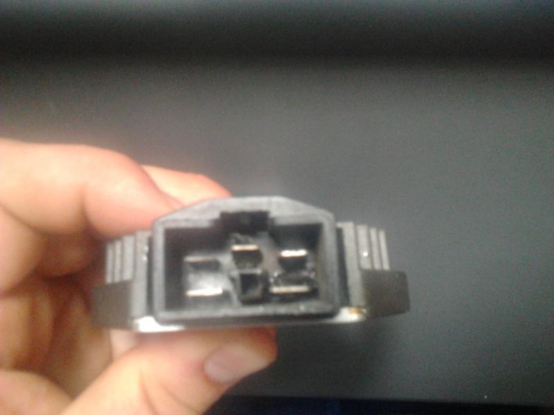

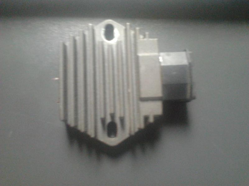

guys you were right it was R/R. negative wire that goes on R/R was fried .
however the part was not original from sh i think it's cbr's it has a pretty big heat sink but still managed to burn itself.
so now i'mm considering to replace it with r1 R/R like someone suggested on this forum does anybody have any experience with that?

that's what i was afraid of. replaced R/R and still no spark. checked side stand switch, kill switch, clutch switch, checked main fuse and all other fuses everything is in place but still no sparks. what else can i check, in other words what else can bad R/R damage.
how can i check ICM
i also checked the pulse generator with my multimeter and i got no voltage at all but i cant tell whether it is because low impedance of multimeter or the pulse generator is faulty
please help me... any suggestion

ripped black/white wire on converter unit.
maybe that is the reason why R/R failed.
now i have new from yamaha r1 2005 i think its mosfet not sure.
one more question with engine not running i have 13.3v on terminals with running engine 13.8v is that enough?
