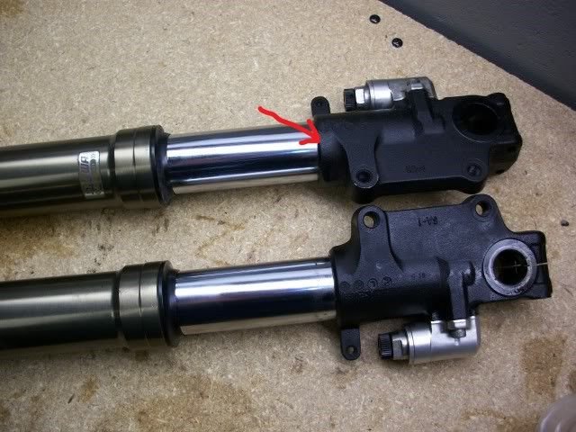

I found a small amount of oil, teaspoon maybe, had leaked on to the disc, wheel and tire, with a little stain on the garage floor
Does anyone know the why or how of an oil leak at the bottom of the fork pipe (that's what Honda calls it) where it goes into the casting that holds the axle, caliper bracket and compression adjuster? These are USD forks from an RC51 SP1. The leak is not coming from the fork seal.
I was hoping that there was a seal involved, but the parts diagram shows the tube and casting as one part. I'm assuming that it is some sort of press fit arrangement. It would be better if there was a seal between the two.
Also the part numbers for the tube is different for each of the first two and only years (2000-2001) for the SP1. Later years are different yet. Wondering if there is any interchangeability between the years.

Most forks have an allen bolt holding the cartridge to the base of the leg. That bolt uses a copper crush washer. It could be leaking or worse, missing, from an incompetent technician.

The oil seems to be coming from the indicated point in the photo. I noticed a very small amount a few years ago when I did the fork swap. Not sure what, if anything that means.

Oh, definitely not a good place for leakage. Are you positive it’s not coming from the seal? That’s not a typical place to leak. Have these forks been in an accident?

No oil on the tube above the indicated junction. As far as I know the forks have not been crashed. There is no visible signs of damage.

I'd say it's probably not coming from there but rather from the mail seals above. It's possible to leak in the area of your arrow, but that's only if 1) the forks were badly bent and straightened 2) someone bodged up a stanchion tube replacement or 3) some other unnatural event.
I'd pop the dust seal down and check for oil behind it. The area between the oil and dust seal should be bone dry, if not that's your problem.

I have been keeping a close watch on the area of interest and much to my mis-diagnoses of the leak, I have determined that it is a common, ordinary seal leak.
Since I have much on my plate at the moment I'm going to try the clear the seal with a thin piece of plastic technique, or maybe some other method that someone might suggest and see if I can put off replacement for a couple of months.

That’s actually good news. A leak where you pointed to would be expensive.
Sealmates (or similar) do work. Carefully pry the dust seal down and use it on the oil seal. Be careful because if you open up that gap, fluid will flow. After swiping around, cycle the fork in and out several times and repeat step 2. Lol. Good luck.

Don't expect too much from this approach. It's an old trick for motocross bikes where you ride through dirt/mud/sand but I'm guessing you haven't done that.
You'll want to look closely at the stanchion tubes for any damage, no matter how tiny. This is the most common reason fork seals start leaking: damage to the rubber from dings or rust pits on the stanchions. Don't just blindly clean or replace seals without identifying the source of the problem - otherwise you'll be doing the job again soon.

Tried a fork seal cleaner from Motion Pro. Seemed as though it worked, then started leaking again, maybe more. Going to replace the seals as soon as the fluid arrives
