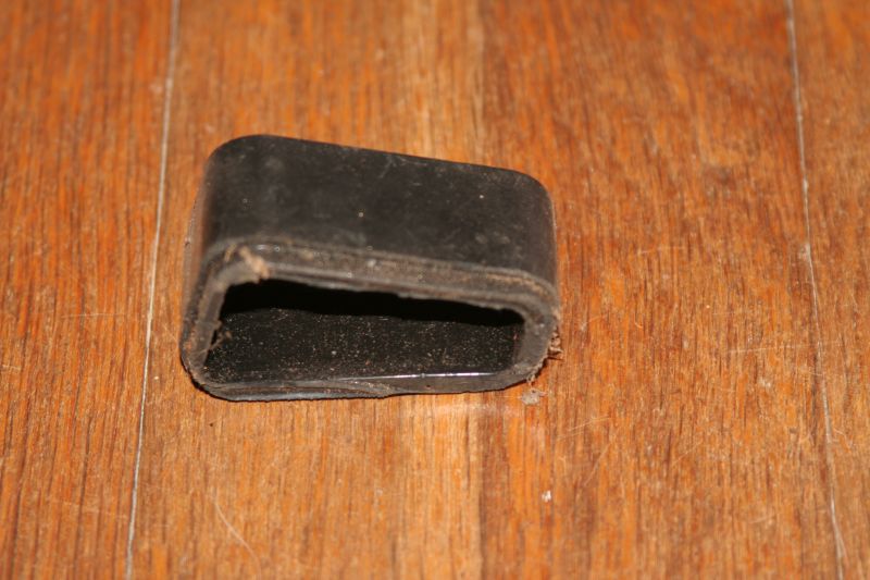

So, my I was working on my hawk, opened the airbox (k&n installed) and noticed some "extra" holes... should these be blocked off? Is this leak the reason why the k&n may not help as much vs stock based on some of the posts? What are the 3 holes in the lower right of the airbox? Seems like they should be blocked off so that dirty air doesnt leak into the system below the filter... thanks for help.

The K&N I have came with rubber inserts to block these off. They definitely should be plugged, but that's not why K&Ns don't help as much as people think they should.

mine came with little foam pieces. I would suggest goign to vip and getting a foam/filter type piece that you can fit in there. at the very least block it off. when i got into the airbox for the first time i noticed the side of the foam that was exposed to the outside was VERY dirty, so don't leave it open to the elements.

Just to add to what Killer5280 and NAVYATR said. You've got to use the rubber block-offs or the engine will drawn in unfiltered air. Also, each of the places blocked off should have a small foam filter element covering the three holes before the block-offs are installed.

Page 5-4 of the Service manual - Crankcase breather. The foam is original, only rubber block off parts come wit the K&N

Just in case some people don't know this: If you get a BMC filter instead of a K&N you don't have to worry about the block-off plugs. They are part of the filter, just like stock.

#10 is the foam inserts. The reason they are there is to allow the diaphragms in the carbs to breath fresh air. .

update, k&n sent me the 'caps' for the airbox holes at no cost/no shipping... sweet!
