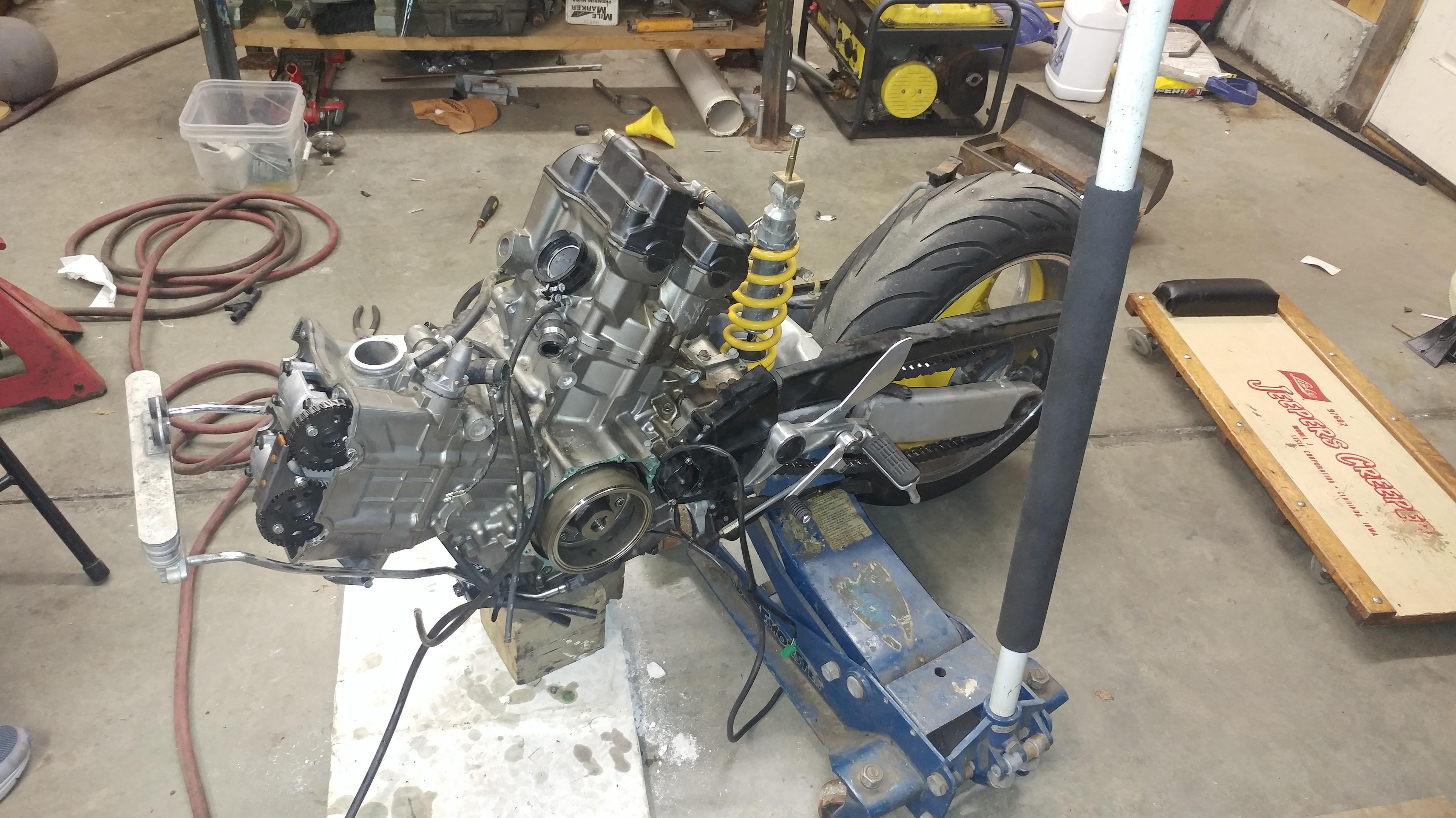

This weeked I was riding when all of the sudden the bike started to make a horrible grinding noise from the engine. After that the bike wouldn't start and only made that grinding noise. The next day it wouldn't do anything, I opened up the left crankcase but couldn't turn the flywheel at all. Last night I pulled the front spark plug and found it was completely shredded up.
99 SH died while riding with grinding noise, need suggestions-0531171743c.jpg
I'm not too experienced in working on bikes, or engines at all really for that matter, however I want to make this bike a project in order to learn a lot more about the bike and in fixing it. I was wonder what some of the next logical steps might be and how to do them. Also I was wondering what would cause something like this? The bike was well kept up from what I know, it does have about 30k miles though. Any help would be very appreciated though thanks.

Welcome Saucy. Heck of a first post, sorry for your loss...
Looks like you'll be doing a lot of tear down. Pull the front cylinder head and report back, lol!
Is it too early to guess cct failure?
Old Jun 1, 2017 | 06:41 AM
Posts: 1,999
No!
Welcome also, and yes, that is looking terrible for a first post.
Well if you really wanted to learn about wrenching you have a good project ahead of you.

Wow thanks for the quick replies. I'm at work now, I'll get to that this afternoon when I get home and will tell you what I find. I'll have to take off the carb to get to the front cylinder head right? Thanks

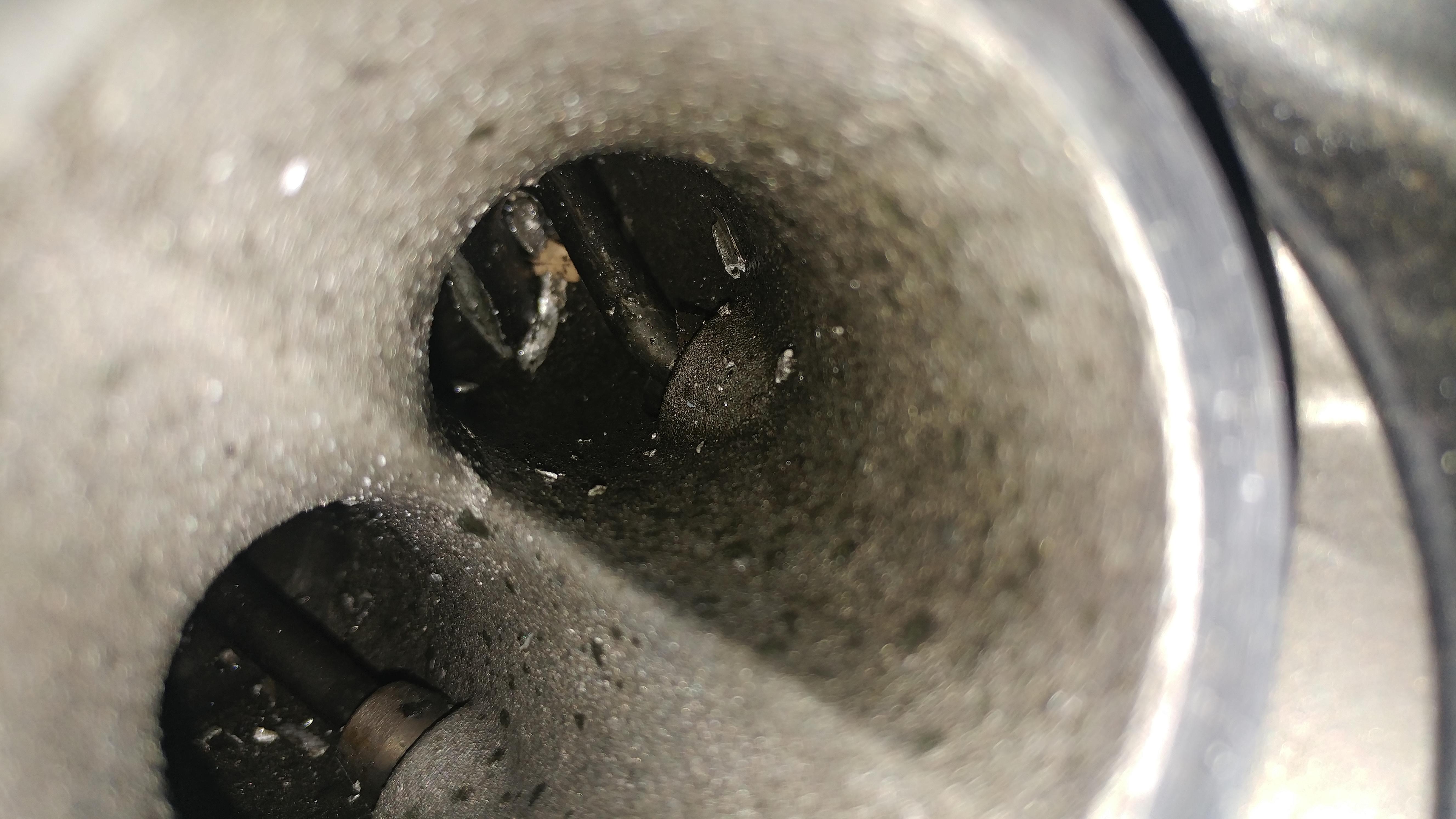

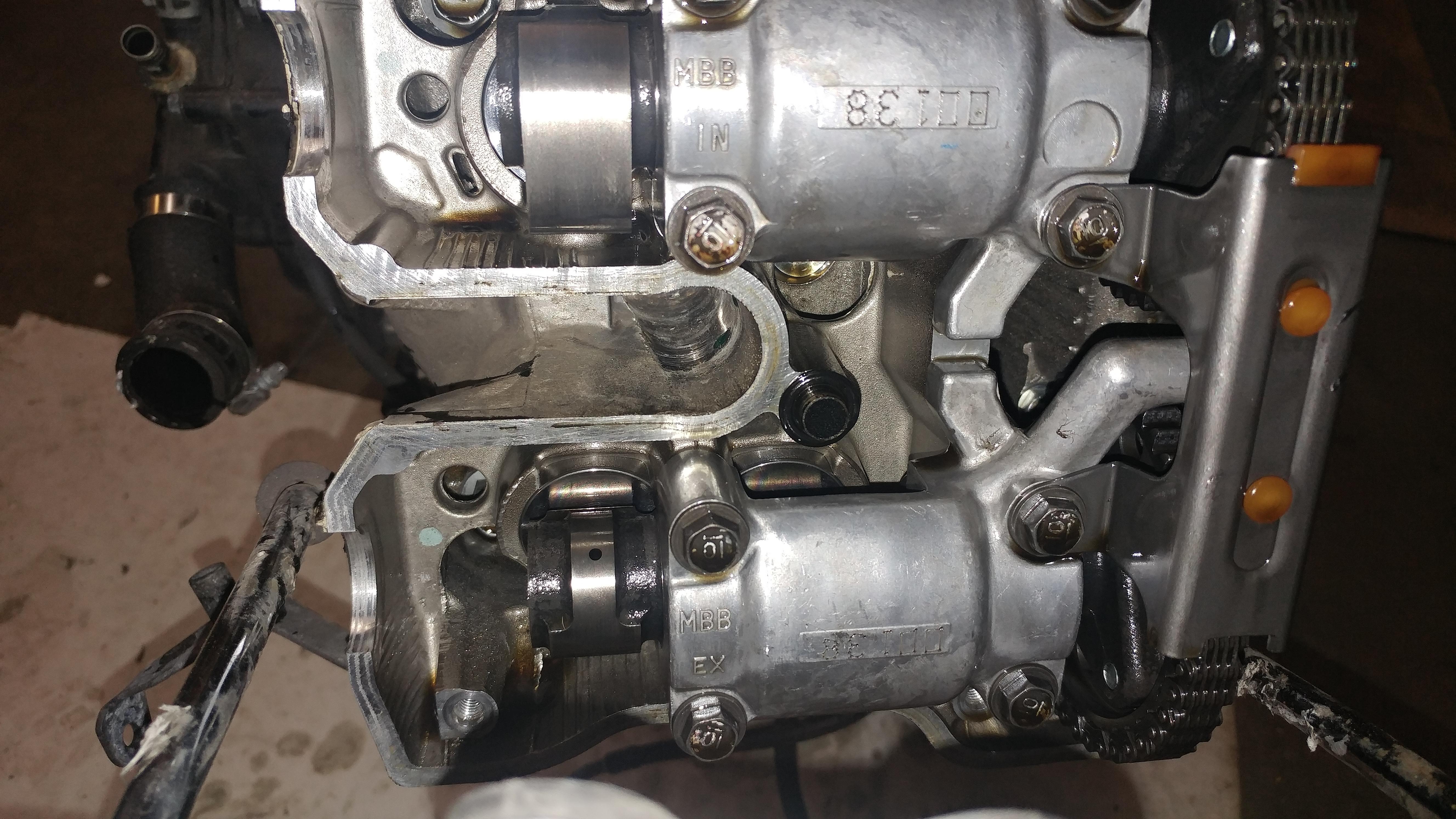

Ok so I dropped the engine out last night. When I got the carbs out I looked into the front cylinder and you could see the piston had gone sideways and there are shards of metal everywhere.
99 SH died while riding with grinding noise, need suggestions-0601171815b.jpg
Also when I went to drain the oil I was very confused when coolant came out, turns out coolant got in the oil and oil got in the coolant. I'm wondering if this was caused by the engine break or caused the engine break, if the ladder I hate whoever did this... I'm going to have to clean every line and part any of these fluids go through to clean out the wrong fluid and any metal shards. When taking the exhaust off its just poured out metal. Any more suggestions haha?

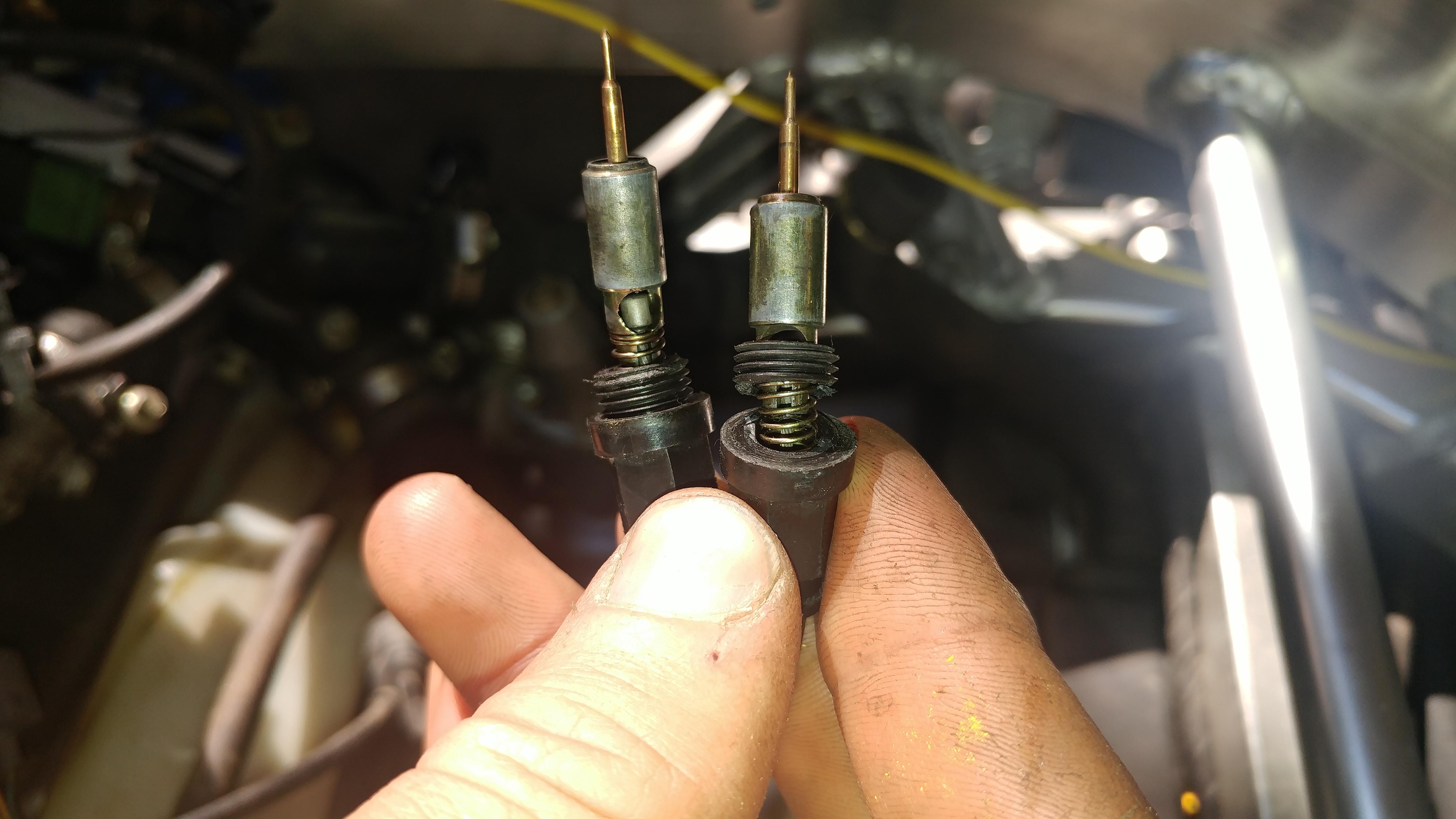

Also, when I went to unscrew the choke from the carbs one of the plastic screws that holds it in was broken. Anyone know where I could get one of these screw cheap? Maybe I could just buy your choke Captainchaos? 99 SH died while riding with grinding noise, need suggestions-0601171831.jpg

Ok so here's where I'm at. I went to drain the oil and coolant. When I pulled the oil drain bolt coolant came out for about 5 seconds then oil, when I drained the coolant there was oil in the coolant. I'm not sure what I should be more afraid of, whether these being mixed caused the engine to break, or the engine breaking caused these to mix. Anyways next I took the carbs off and when I looked in the cylinder I could see one of the piston rods bent with shards of metal everywhere. From what I've been reading on this forum this sounds like the CCT failure you guys were talking about?

Me and my friends ended up taking the engine completely out and are going to have it looked at by a guy who rebuilds car engines. Any idea if this engine will be worth fixing or even fixable at all? What would need to be fixed most likely? I figure cause of the oil/coolant mix and the metal shards in the engine, anything connected to the oil or coolant lines should be completely cleaned out or replaced completely.

Also when taking the carbs out one of the plastic screws that holds the choke lines into the carbs was broken. Anyone know where I could get one of these screws cheap possibly? Or maybe I could get the one from captain chaos? Thanks a lot guys

Sounds like a new engine - and some Krieger MCCTs http://www.clems-garage.com/CCT/
Choke fittings > Aluminium Choke Valve Guide - Rugged Roads

SaucyDinosaur: It sounds like your engine is 'toast'. Confirm it with the mechanic.
If it is in fact in need of a rebuild (or worse) a replacement engine is going to be a lot more efficient and most likely more cost-effective way to approach the problem. I say this based on experience. Also, I would not use a good, running engine for parts to re-build the current engine. I'd do it the other way around, save any usable pieces from your current engine...but put the replacement engine in, change to manual CCTs...and ride.

Dino, the last photo, enrichment cables. Contact Jack Flash for brass replacement parts.

Ok so the engine is definitely a goner and I ordered a new one. I was just wondering, when I was talking to the seller he also agreed it was probably CCT failure but also could've been fuel getting into the oil. Does that sound possible? I went through and started cleaning the carbs and didn't find anything that seemed to be bad. Where would I check for a problem like this? Before it died I had a slight suspicion that too much fuel was getting injected by the carbs and was getting just under 30 mpg. It seems to me that that's too low of a number, I just don't know if that low mpg could've caused the failure or just a waste of fuel. When the oil was drained I didn't notice a smell of gas but I also wasn't checking for it at the time. I guess I could see if it still smells like gas somewhere in the engine where there shouldn't have been gas.

If you've disassembled the engine, did you find evidence the piston(s) met the valve(s)?
Alan
Oh ya, the entire piston head was smashed in
