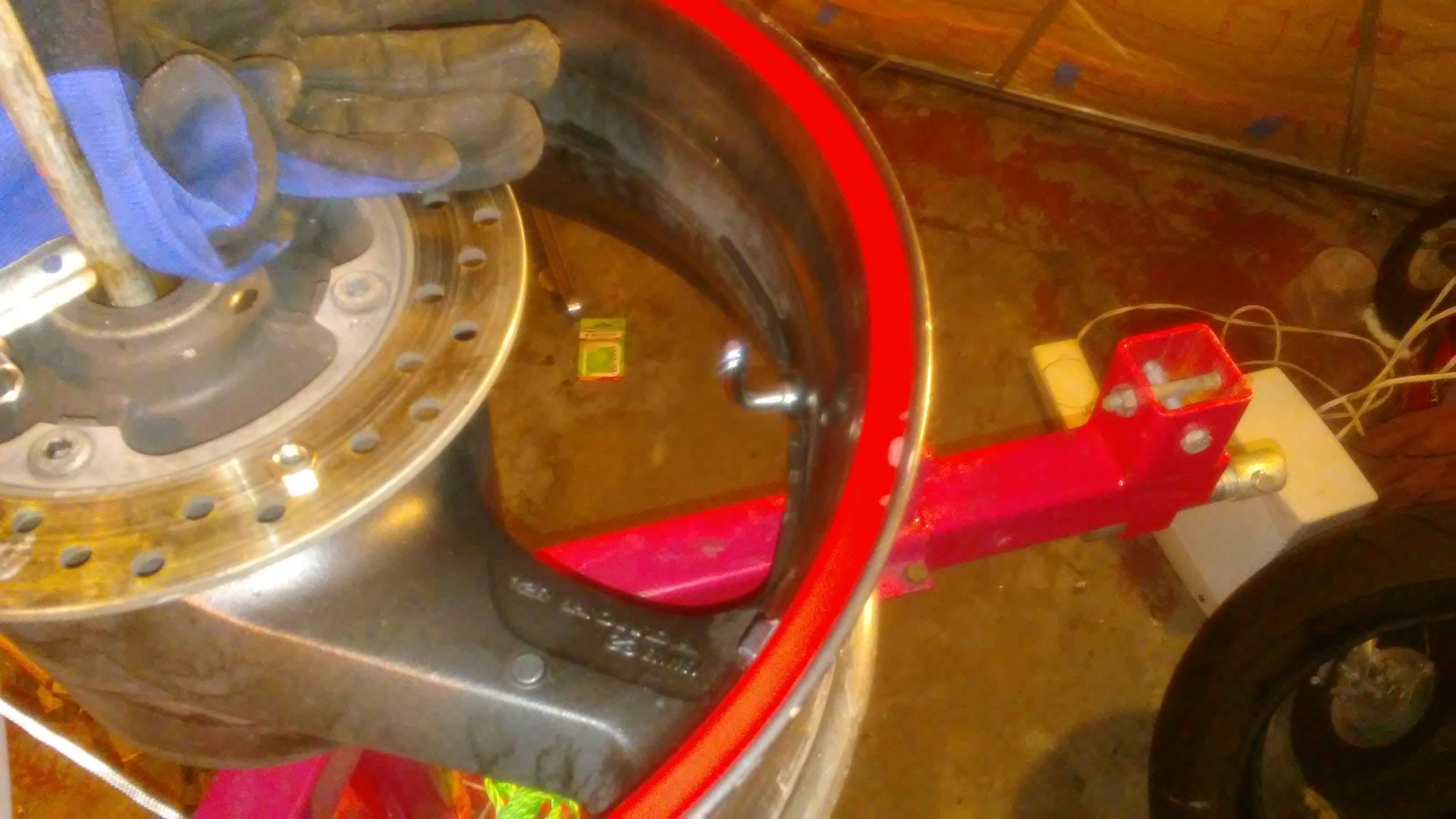

Ok so just installed new tire. Never fun in winter but I put a space heater in my garage to keep it doable.
As soon as I finished it started snowing hard so decided to wait for a test ride.
Later it was 33* so not much leaning. Tire feels great, handling way better but old tire was really squared off. Always so much to do on these jobs. Clean & lube chain, clean brake caliper (need new pads).

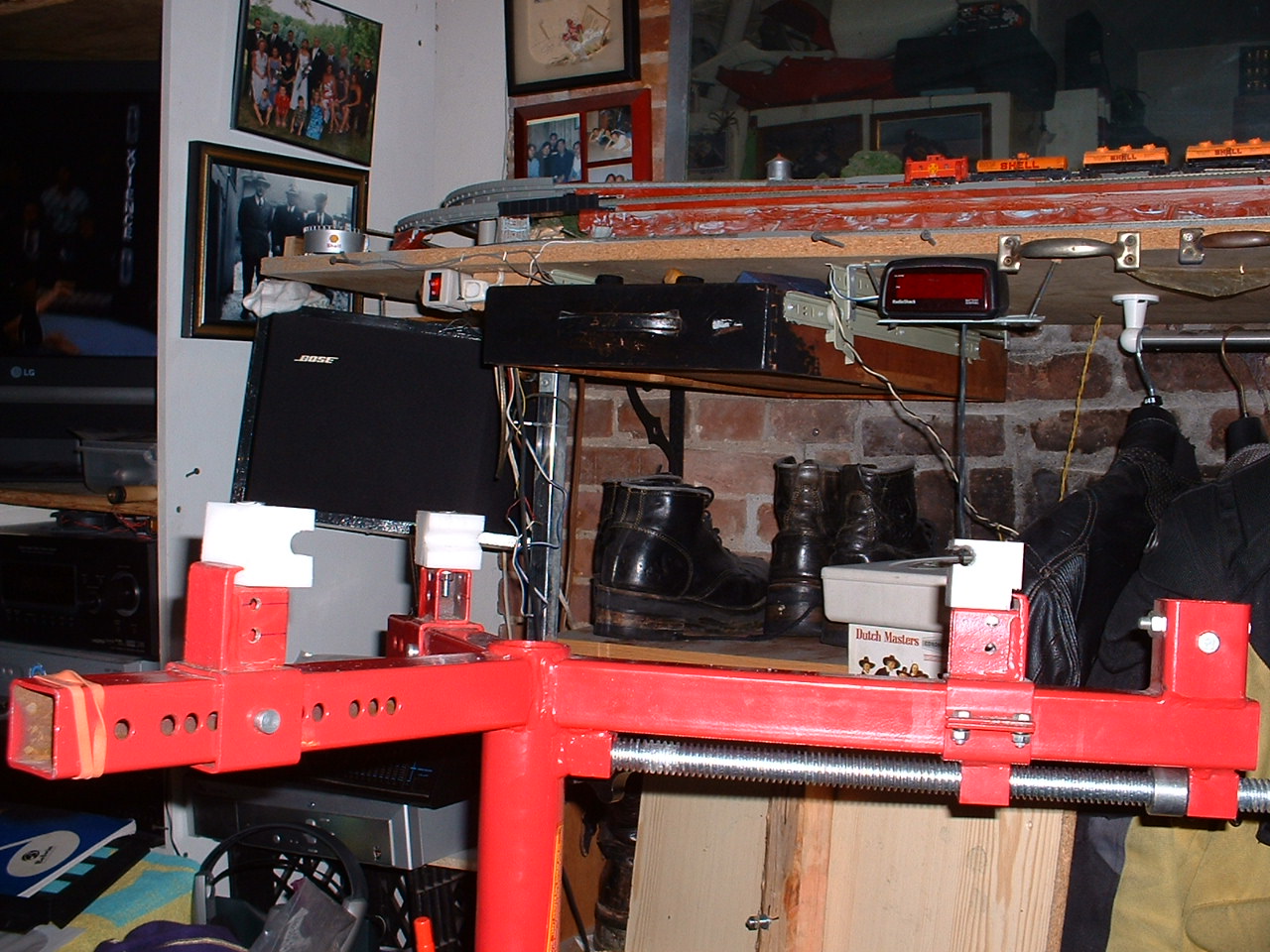

That is actually a minimoto 18 volt RVT bike I got for my son. I can actually ride it. Pretty cool.
Yes a harbor freight tire changer with the motorcycle adapter. Drove to Conn to pick it up since the discontinued the moto adapter.

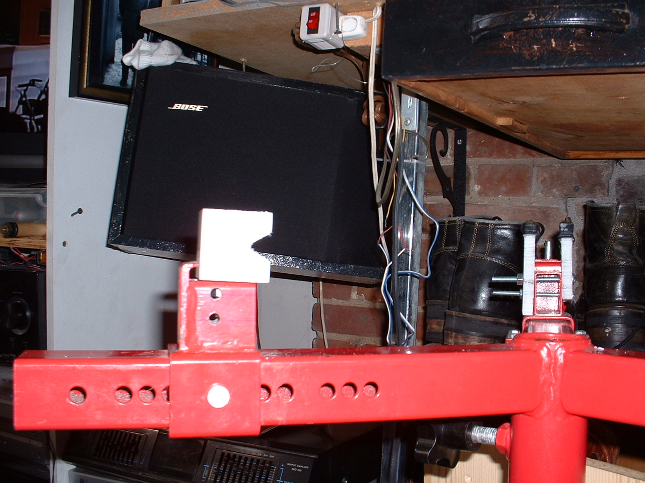

I made my own delrin wheel holders.
I use the no mar bar with it.

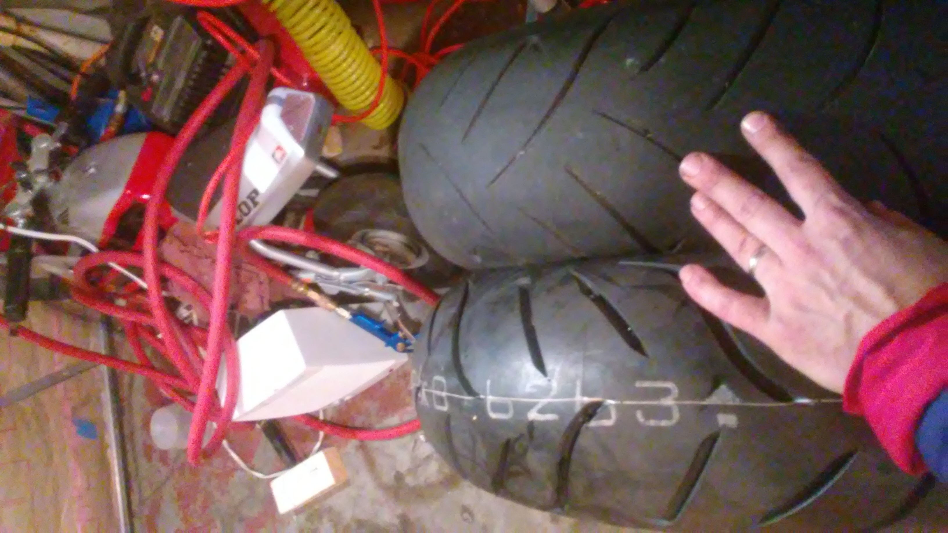

So back to the regular program, the new tire is noticeably taller. I can barely go in reverse due to feet reach issues. The bike leans a lot even though I have a sidestand extender plate.
Handling is great but I will lower the rear somehow. Probably some lowered preload and ride height.
Oh and it does hit the hugger, but I will remount that tomorrow.

Reducing preload and ride height is not the way to go, and it will grow at speed so static hugger clearance will not be enough.
Did you see tt the oem size tire was available for $112 too?
Bottom line, sell it and go back to a 18p/55 or at most a 19p/50.
Take your lumps and live and learn literally because compensating and compromising can kill you!

your better of using a 180/55 rear. the storm rim size was designed for a 180. for a 190 to keep the shape it was intended to be needs a 6" rear rim. iv tried both and its a lot nicer with the 180 rear..imo.
