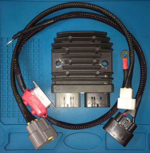

Confirm by checking charge voltage when running at idle and about 3000 RPMs.
The symptoms you listed do point do a failed regulator rectifier which is kind of common . Confirm, repair or upgrade and go ride

Shameless plug...E. Marquez's RR upgrade is the way to go. Plug and play.
Old Aug 4, 2019 | 07:17 AM
Thanks.
Michael Semick, give a shout here or at https://www.facebook.com/WeBuildAdventure if I can help.
