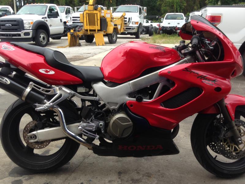

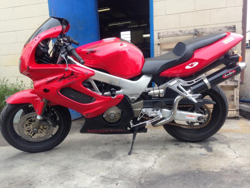

Yes, everything with them does seem good besides the stuff I mentioned before, I am posting pics of them on the bike, and i will be installing the pedal return spring today as well, so I will take a few more showing the adjustments i have made.

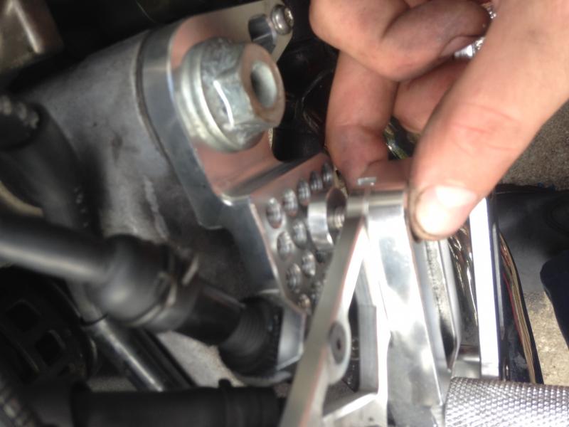

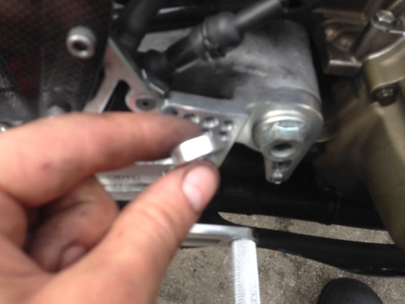

The black bolt is the one I drilled out and used a larger bolt.
This is the 6mm spacer that Danmoto forgot in my kit (should have 4 in kit, and also 4 longer mounting bolts)
That is the how the mounting bolt and spacer are put on the set to space it away from adjusting bracket.
That is the finished product

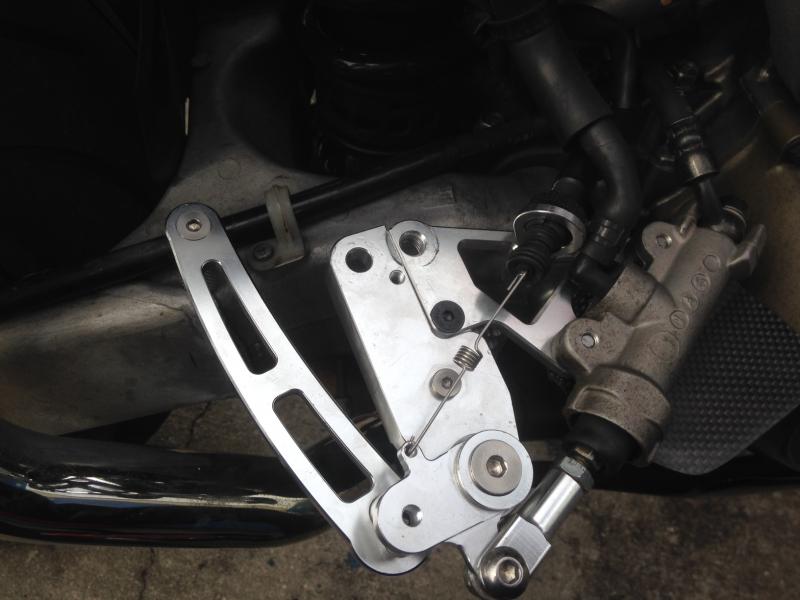

The only real thing I don't like about them, is the lack of a brake pedal return spring, which I am in the process of fabricating with an eyelet and a throttle return spring from a carb. Once I get that sorted I will post more pictures and how to install it.
