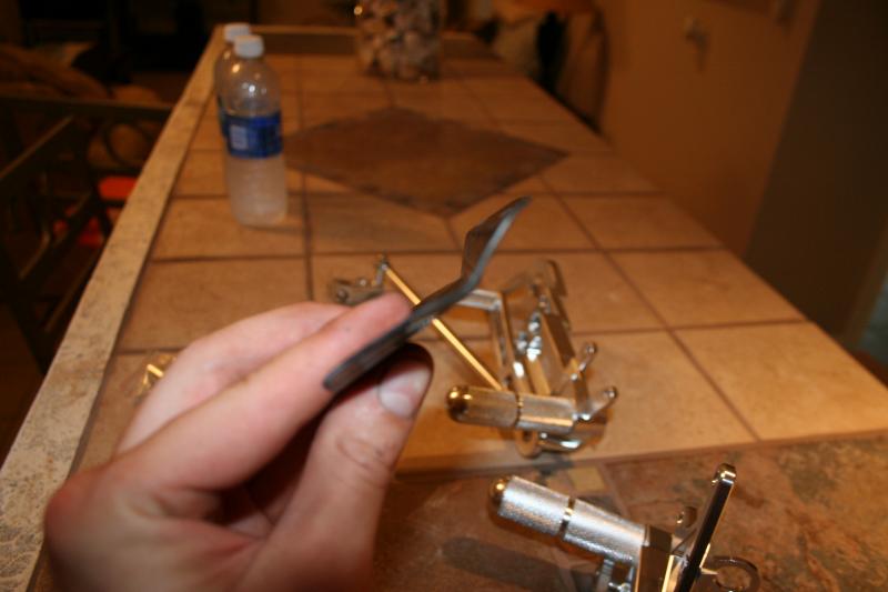

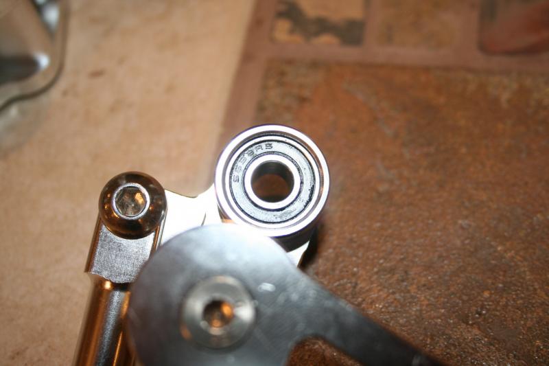

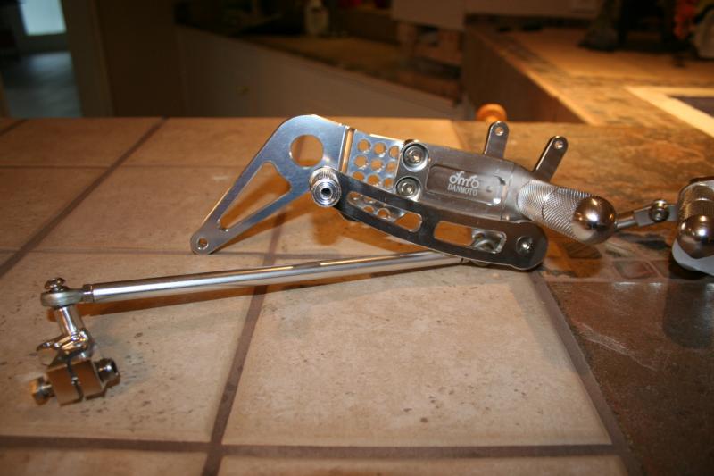

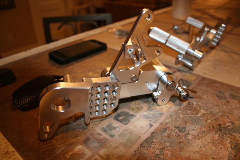

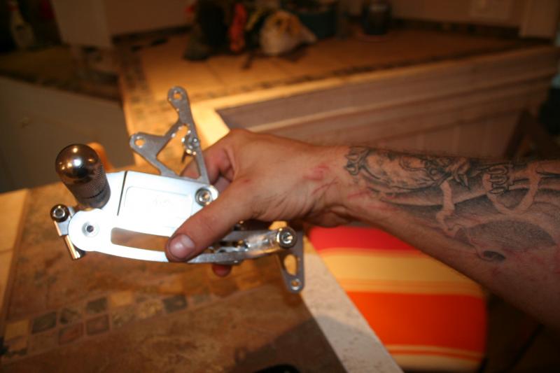

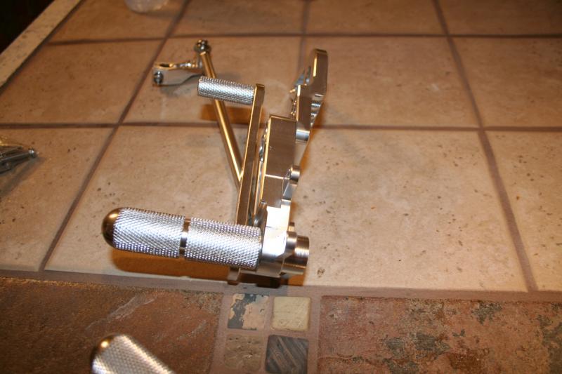

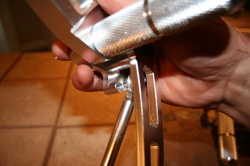

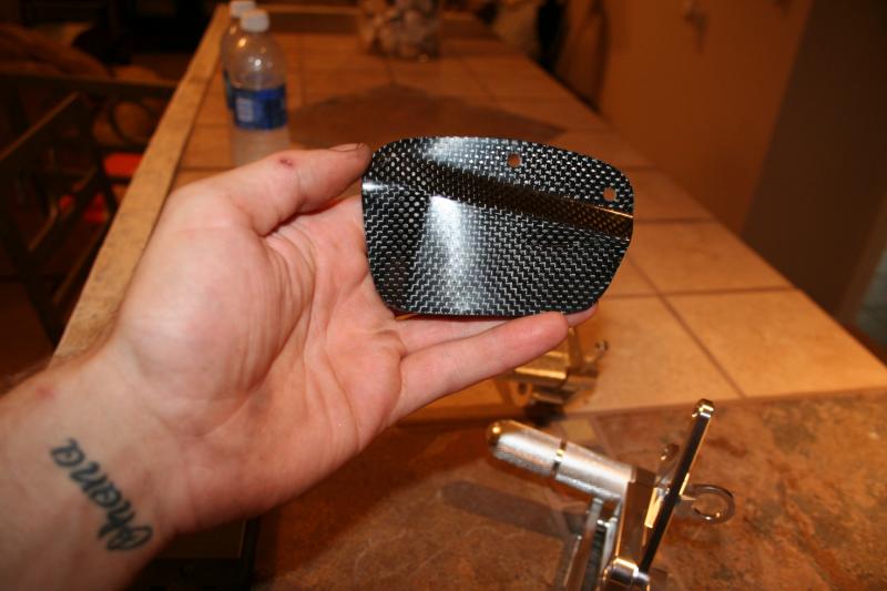

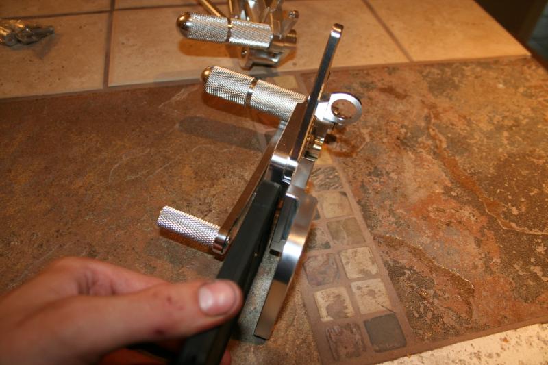

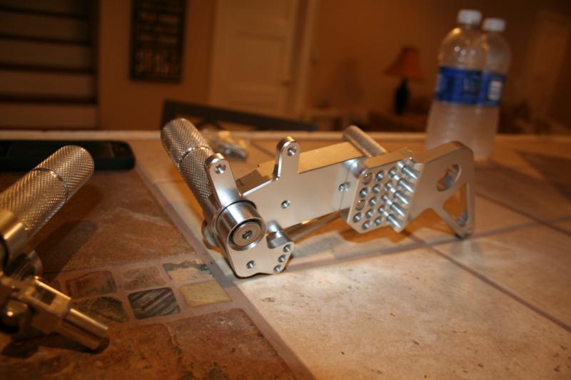

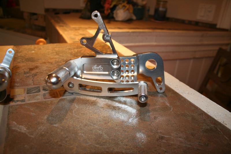

Ok guys, they came in today. Here are some better pictures of them. I will not have a chance to do the install till wednesday, so I will just be doing coments of how they feel and look as of right now.

Ok, now that all the pictures are uploaded....
Positives- The sets feel great, the pegs with the perforations are extremely grippy, the sets feel very solid and stiff, the adjustability is quite a bit, and the shifter position is adjustable ( about 2 inches back from stock rear sets, all the way up to about 2-3 inches closer, and the can be about 1/2 - 1 inch higher or lower than stock) which is nice. The are pretty thick so hopefully the will be durable in the event of a low side. the shifter and brake lever both have the perforations to add some extra grip to them, and both the shift lever and brake lever both have 2 ball bearings each in them at the attachment point so they move freely.
Negative- IMO the only down side so far that I could find is the small whimpy heal guards, they don't feel very durable (they are real carbon so I am sure they are) and they are pretty small, so I wont be able to comment more on that till they are on the bike and I get to try them.

Honestly I think even the stock heel guards are a little small.. being an R/C dealer I can order blank sheets of carbon fiber in varying thicknesses so I may end up making my own at some point.. I have a fairly huge foot though.
Still interested in your write up, those look pretty pimp and while I'm happy with the stock location of the pegs I may end up having to get a set anyway
