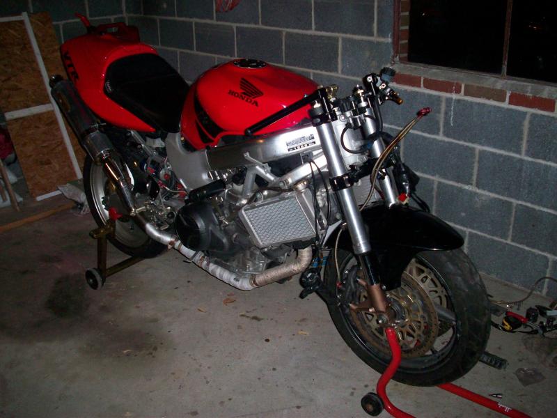

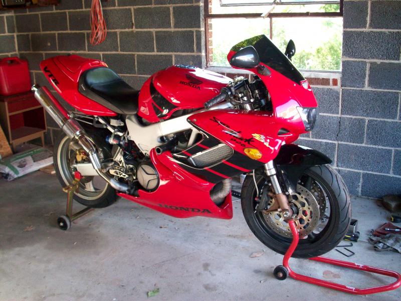

So here is a few picks with her all put back together. Just waiting on the stock 1000rr master and gotta put new fork seals in and hopefully im good. The only thing is when I hold the front wheel straight it seems like the upper tripple is just a hair off from the wheel. Really gotta stare at it to notice. Also I was never able to get the measurement exactly right with the distance from the center of the axle to the upper tripple. It seemed like I just didn't have enough fork to slide up any higher. Any opinions? Im going to a local suspension specialist and hopefully he can keep me from going crazy...

Well, the fork is shorter than stock, so the unloaded measurement will not be the same at all... But since the springs are stiffer, the measurement with the bike on the wheel should be close to the same...
One trick to get that to evened out if it might just be from the mounting, nothing bent, is to loosen all but the lower clamp, and then shake it all around...

t-dogg's Avatar
Joined: Nov 2008
Posts: 360
From: Florida panhandle
Hmm...I'll have to try that. Didn't realize how much there is to adjust afterwards. Thanks for the tip!
